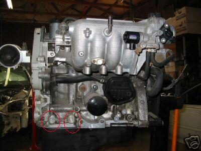

okay...here is the drivers side* of a 4 banger honda motor
the 2 red circles are towards the front of the engine, a mount can be made to bolt there and go forward, this in turn would mate to a mount that you have bolted/welded to the firewall
*once motor turned 90° in the correct orientation

Mueller   now if you look at the other side of the engine, t...   Dec 16 2004, 01:18 AM
