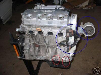

now if you look at the other side of the engine, the blue circles are the factory motor mounts if you removed that , the 2 red circles have bosses that can be used to mount the motor.....pretty simple if you ask me (IMG:style_emoticons/default/smile.gif)
if space permitted, you could always fabricate a mount that ties the the "drivers side" of the engine to the factory mount (in blue) and hang the motor off the front of the engine....this is sorta how it is done on Boxsters and factory 914/6 engines (even some 914 /6 conversions with much bigger engines)

Mueller   okay...here is the drivers side* of a 4 banger hon...   Dec 16 2004, 01:12 AM
Mueller   now if you look at the other side of the engine, t...   Dec 16 2004, 01:18 AM
