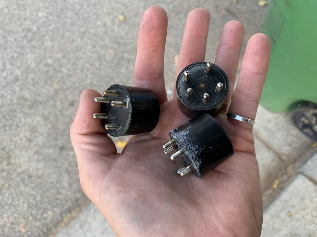

KELTY360   Fuel pump relay on the relay board. I've had ...   Jun 23 2020, 02:56 PM

KELTY360   Forget about the fuses. It's the fuel pump REL...   Jun 23 2020, 10:17 PM

johnpierre   so here is the update: fuses arrived from pelican...   Jun 25 2020, 08:26 PM
johnpierre   old relays   Jun 25 2020, 08:28 PM
