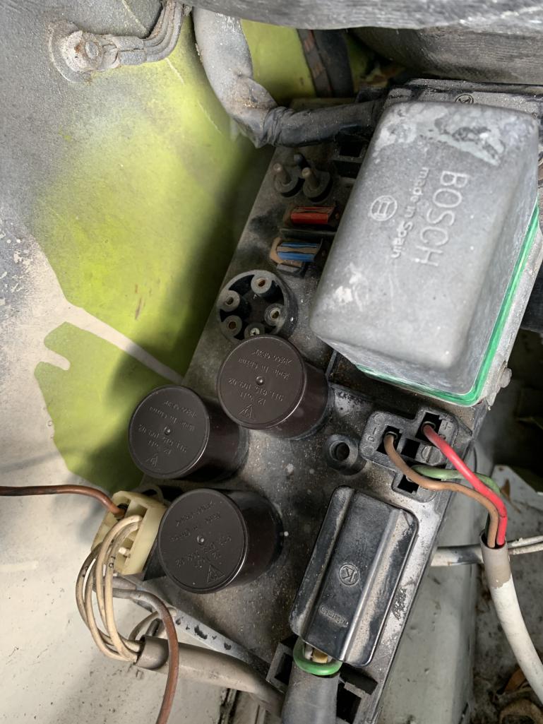

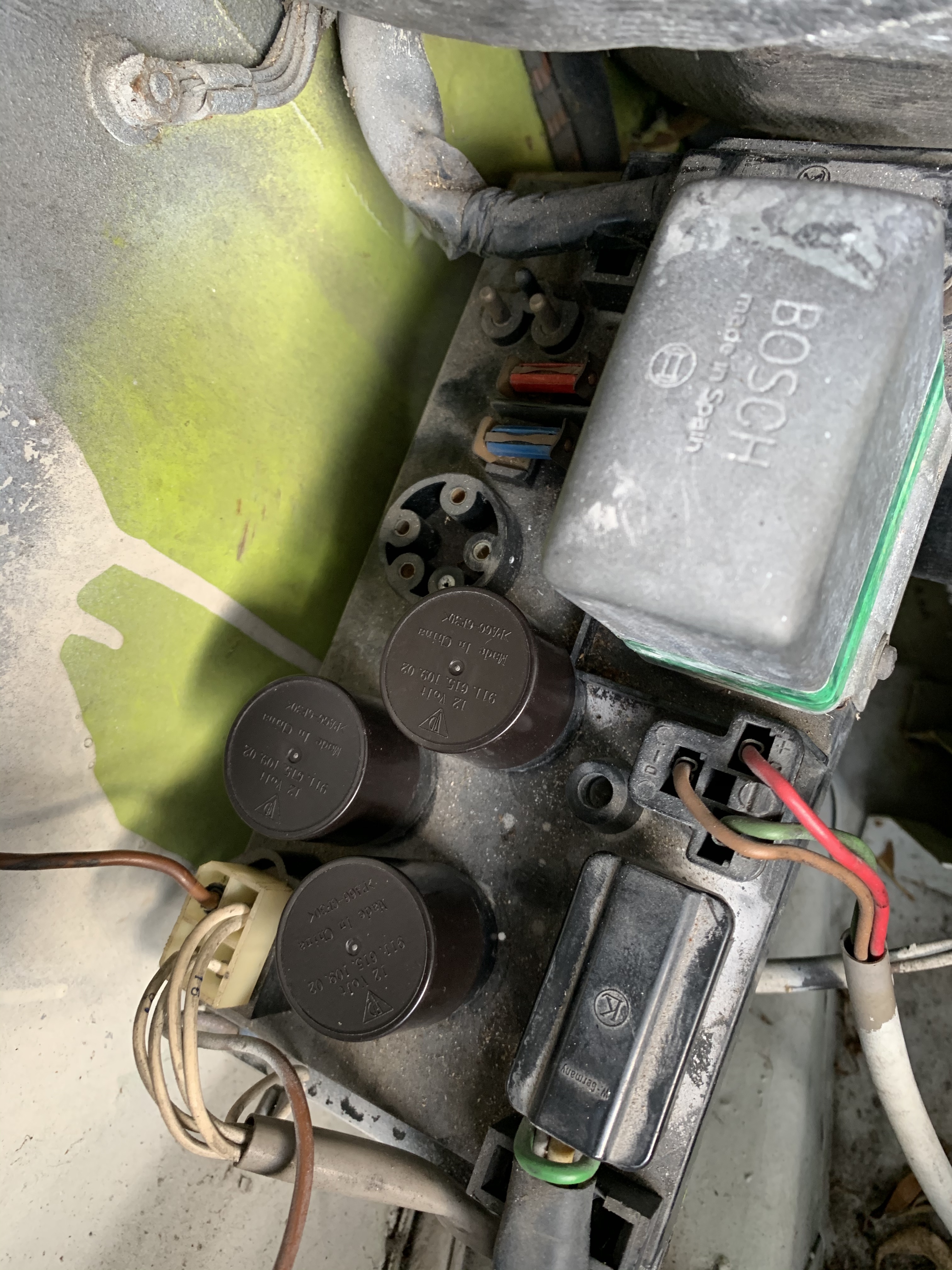

johnpierre   so here is the update: fuses arrived from pelican...   Jun 25 2020, 08:26 PM
johnpierre   old relays   Jun 25 2020, 08:28 PM
johnpierre   relay board with new relays installed   Jun 25 2020, 08:29 PM
