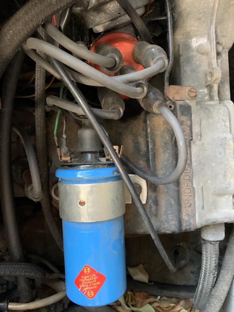

coil / distributor cap area - looks to be ok right ???

johnpierre   coil / distributor cap area - looks to be ok right...   Jun 25 2020, 08:31 PM
