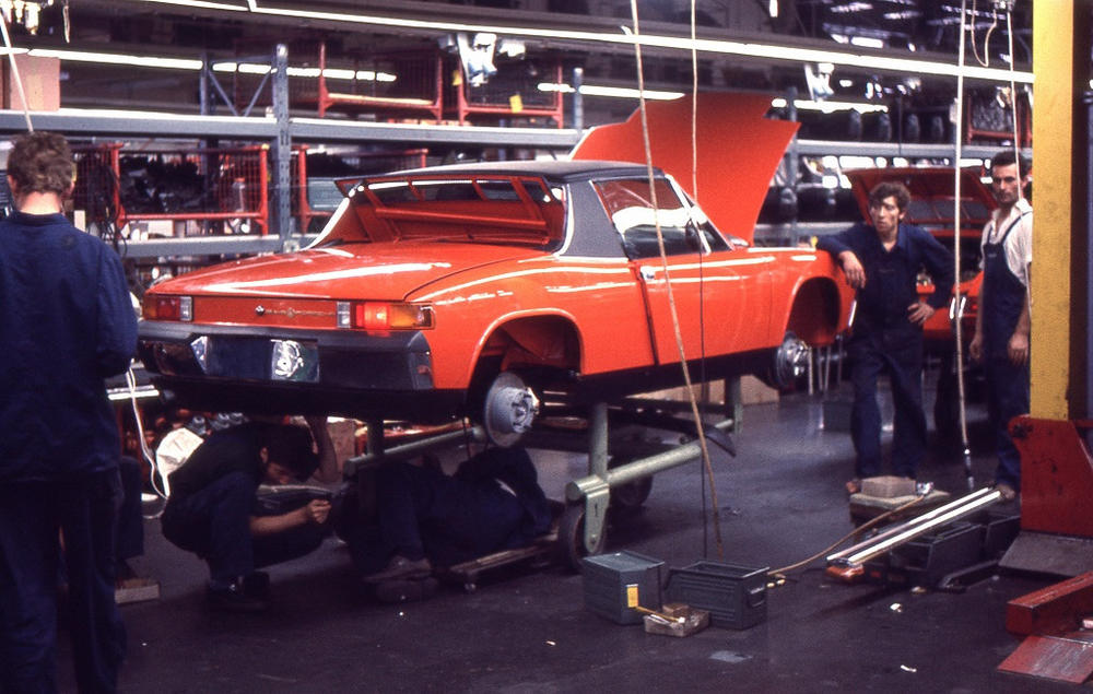

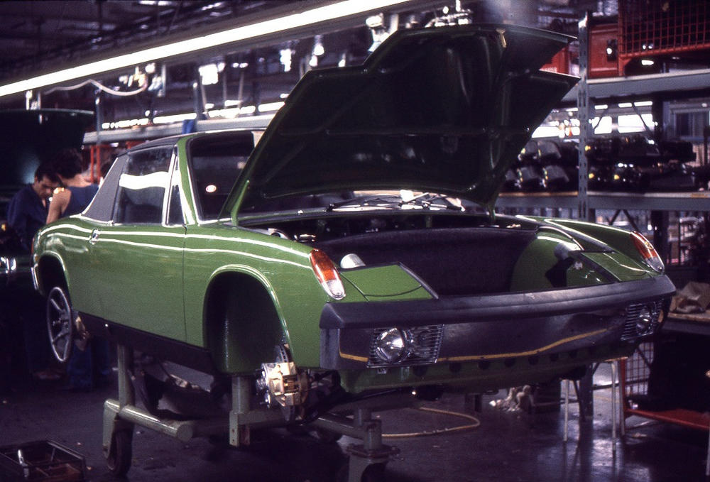

SirAndy   The donuts were used to suspend the cars on the as...   Mar 25 2020, 11:17 AM

SirAndy   And if you check the location of the donuts in the...   Mar 25 2020, 11:19 AM
