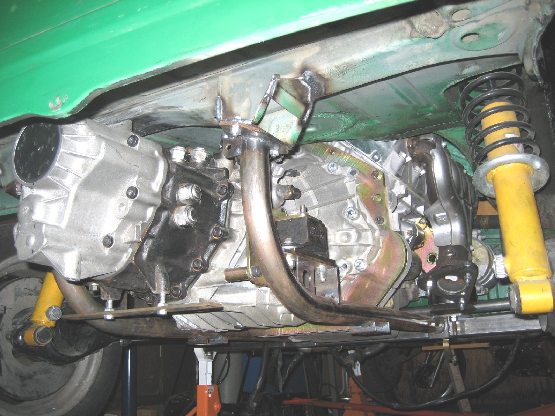

This is what I did for my cradle in case it helps. Different trans, different motor, but it's a cradle nevertheless. I paid a hotrod shop to make the bends.
Andys
