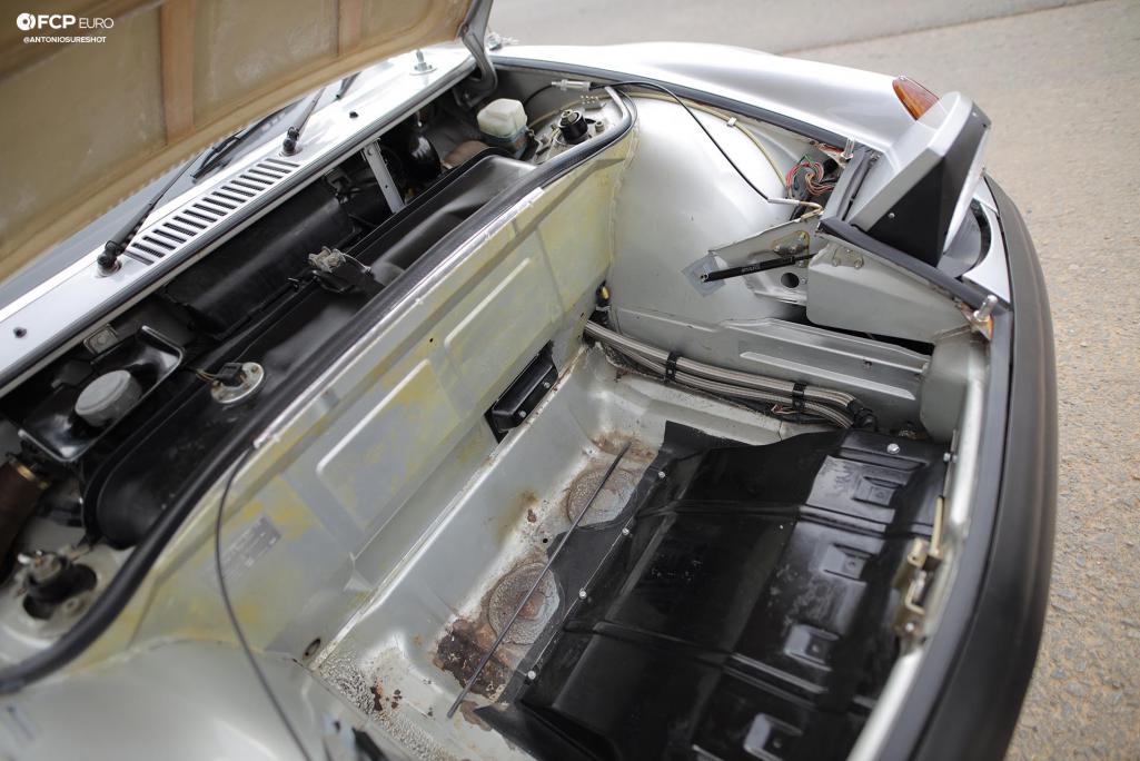

For everybody out there running a GT style cooler, would you mind posting a few photos of your cooling setup and fans?
Currently re-routing my system to use a SETRAB type cooler (example here: Patrick Motorsports Website) however I don't see any reference to fans, and it doesn't seem as though it's an option to purchase.
Also, appreciate any 'pointers' in the right direction when it comes to vendors that might have similar products / solutions. Thanks in advance for your help!

No fans on a 3.2 six. My temperatures used to be dramatically high on the gauge till I replaced the sender with the proper one for the guage... (IMG:style_emoticons/default/blink.gif)
Curious if you are running a Steve Wong Chip? Mine seems to run a little hotter with the chip, but it's worth it. Drive-ability is night and day better. Much smoother response.
Mine is also a high compression Euro 3.2 motor, which probably also makes it run hotter.
