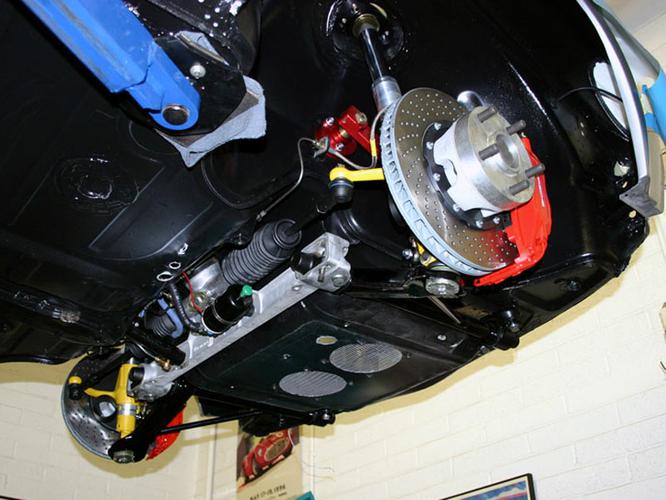

GregAmy   Holy shit that's a gorgeous underside you have...   Jul 20 2020, 03:19 PM
RiqueMar   Holy shit that's a gorgeous underside you hav...   Jul 20 2020, 05:30 PM
