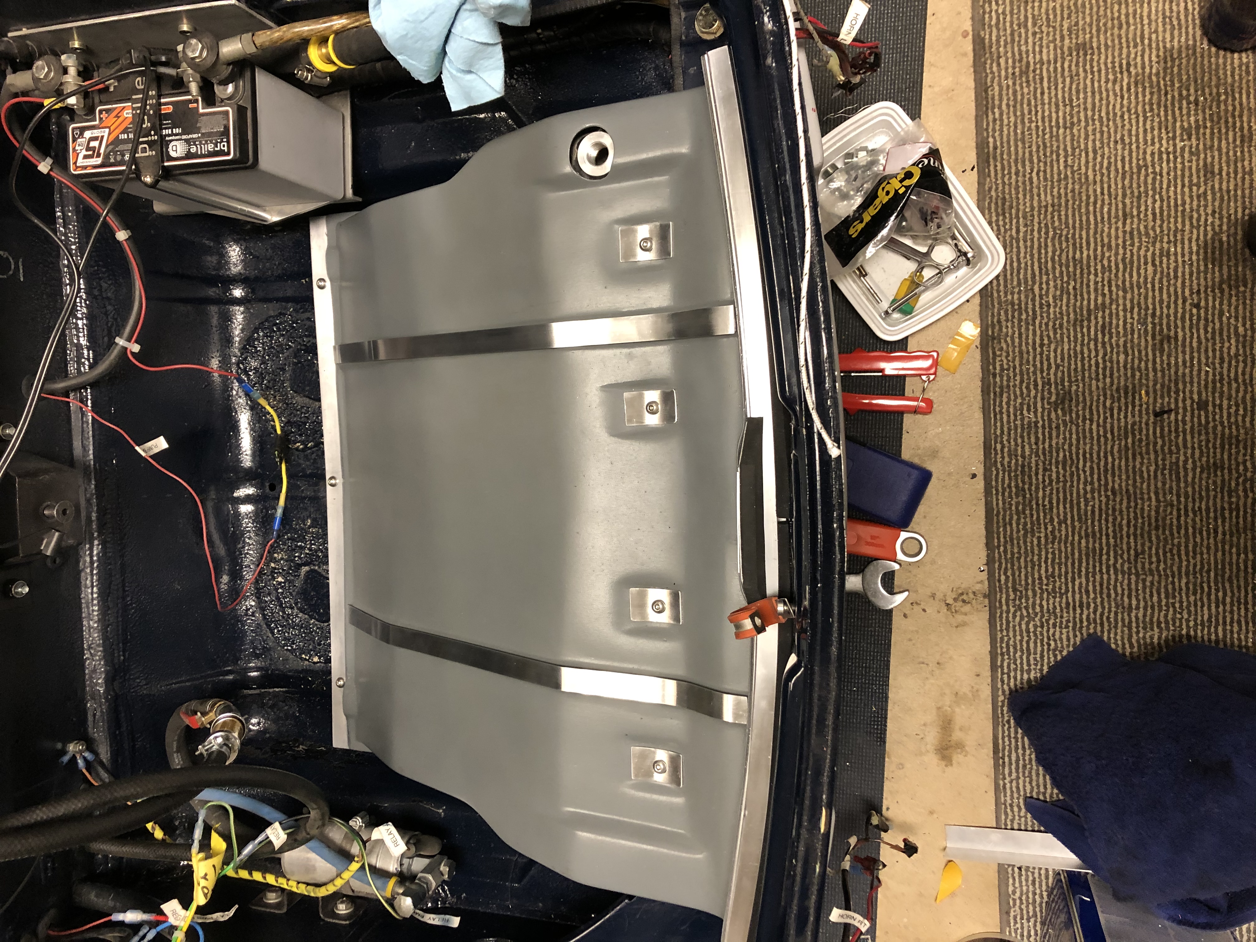

For everybody out there running a GT style cooler, would you mind posting a few photos of your cooling setup and fans?
Currently re-routing my system to use a SETRAB type cooler (example here: Patrick Motorsports Website) however I don't see any reference to fans, and it doesn't seem as though it's an option to purchase.
Also, appreciate any 'pointers' in the right direction when it comes to vendors that might have similar products / solutions. Thanks in advance for your help!

NOS RX7 oil cooler with widened GT shroud to fit cooler

Marv's3.6six   Here is my system which is a Patrick Motorsports S...   Jul 22 2020, 09:28 AM
Marv's3.6six   System with Getty CF lid installed.   Jul 22 2020, 09:40 AM
eric9144   You've still got a rear trunk right ? man th...   Jul 22 2020, 09:49 AM
RFoulds   I like the shroud that vents out the side, but min...   Jul 22 2020, 10:24 AM
