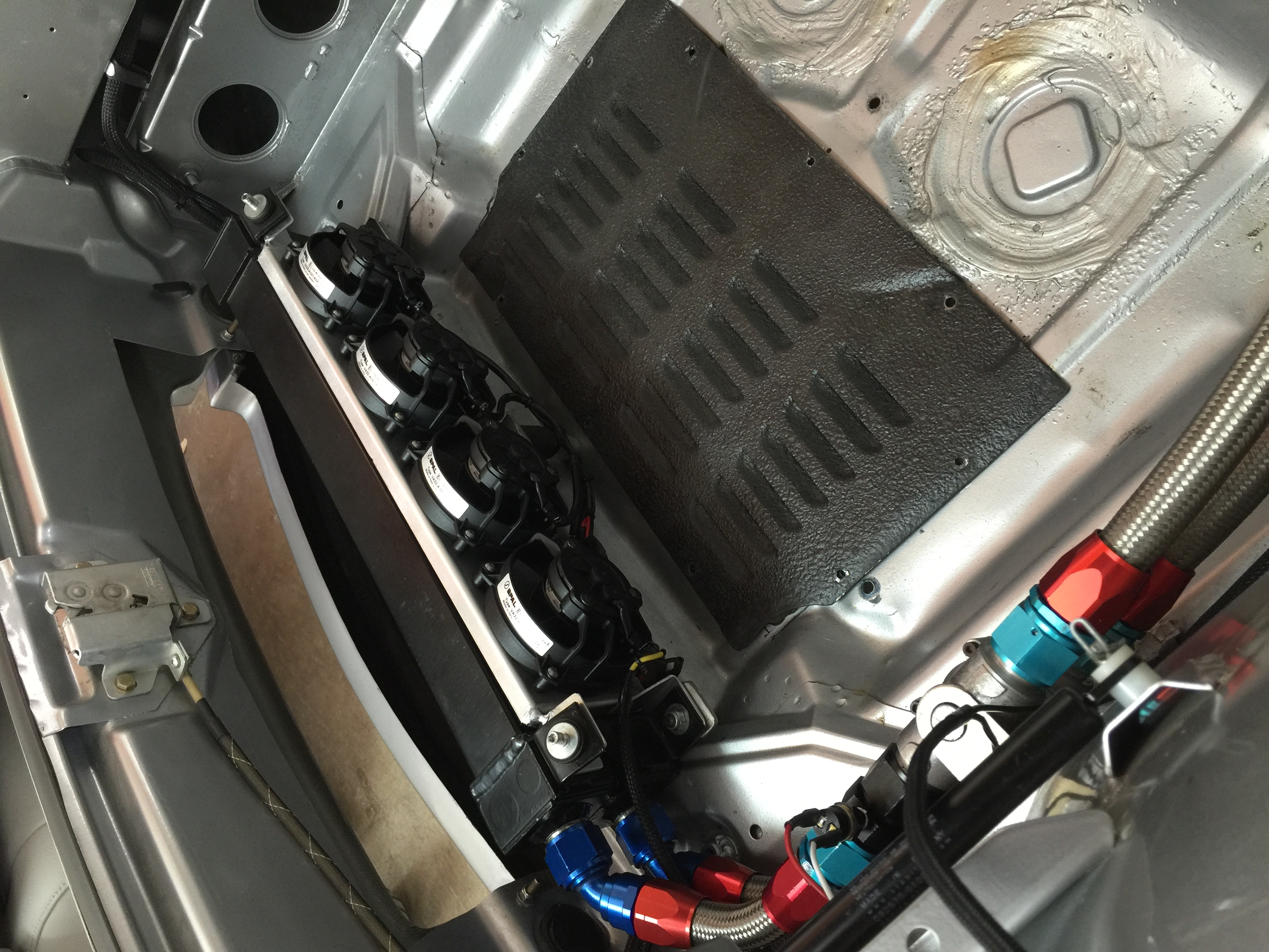

Here is my system which is a Patrick Motorsports Setrab unit on a modded 993 3.6. I ran mine for a couple years without fans BUT I got caught once on a backed up freeway and the temps went thru the roof. I added 4 puller fans with a tstat switch. The system configuration, install, fans, and electric circuit were all my design. This system has been a life saver.

Marv's3.6six   Here is my system which is a Patrick Motorsports S...   Jul 22 2020, 09:28 AM
Marv's3.6six   System with Getty CF lid installed.   Jul 22 2020, 09:40 AM
eric9144   You've still got a rear trunk right ? man th...   Jul 22 2020, 09:49 AM
