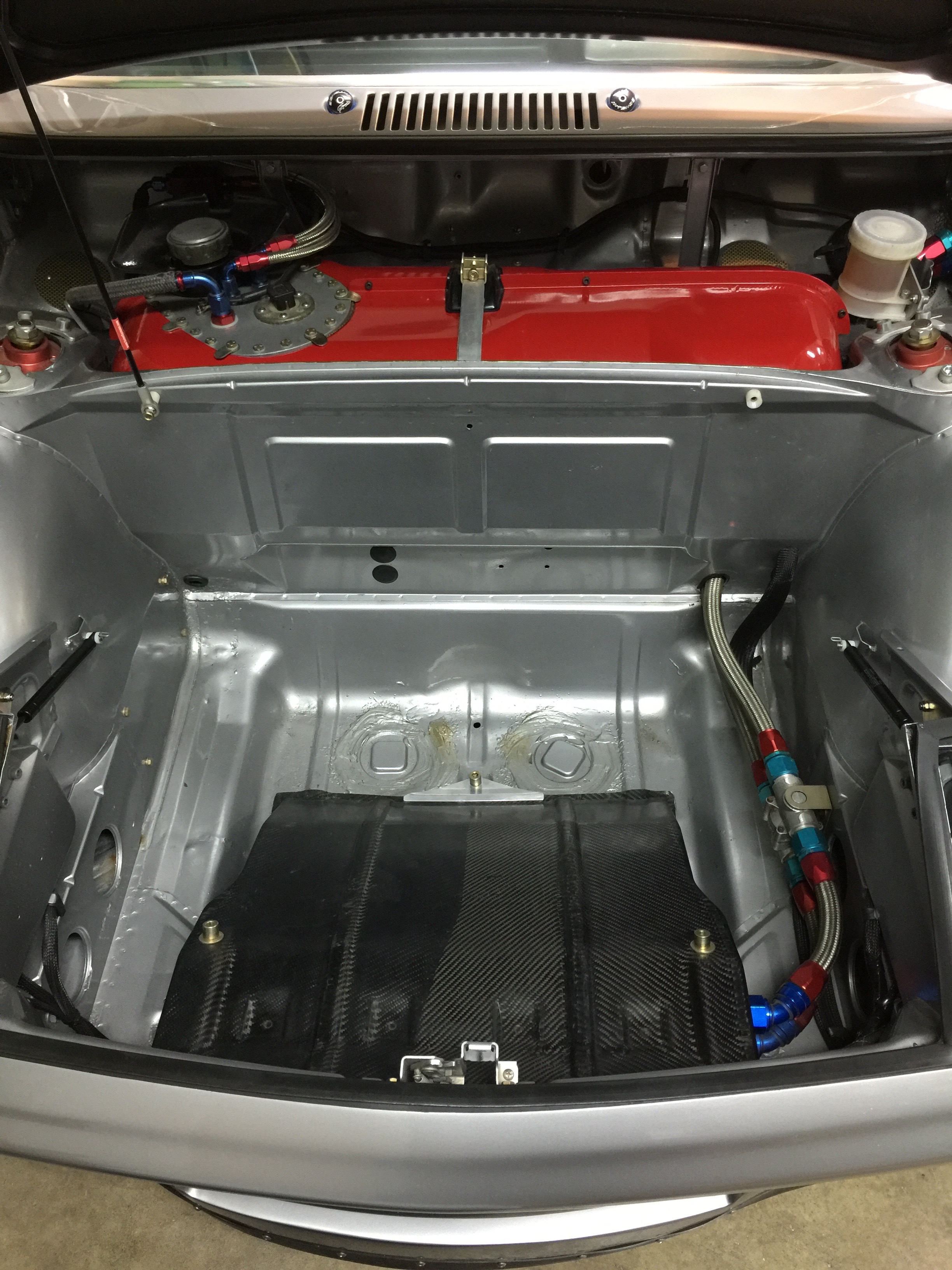

Marv's3.6six   Here is my system which is a Patrick Motorsports S...   Jul 22 2020, 09:28 AM
Marv's3.6six   System with Getty CF lid installed.   Jul 22 2020, 09:40 AM
eric9144   You've still got a rear trunk right ? man th...   Jul 22 2020, 09:49 AM
