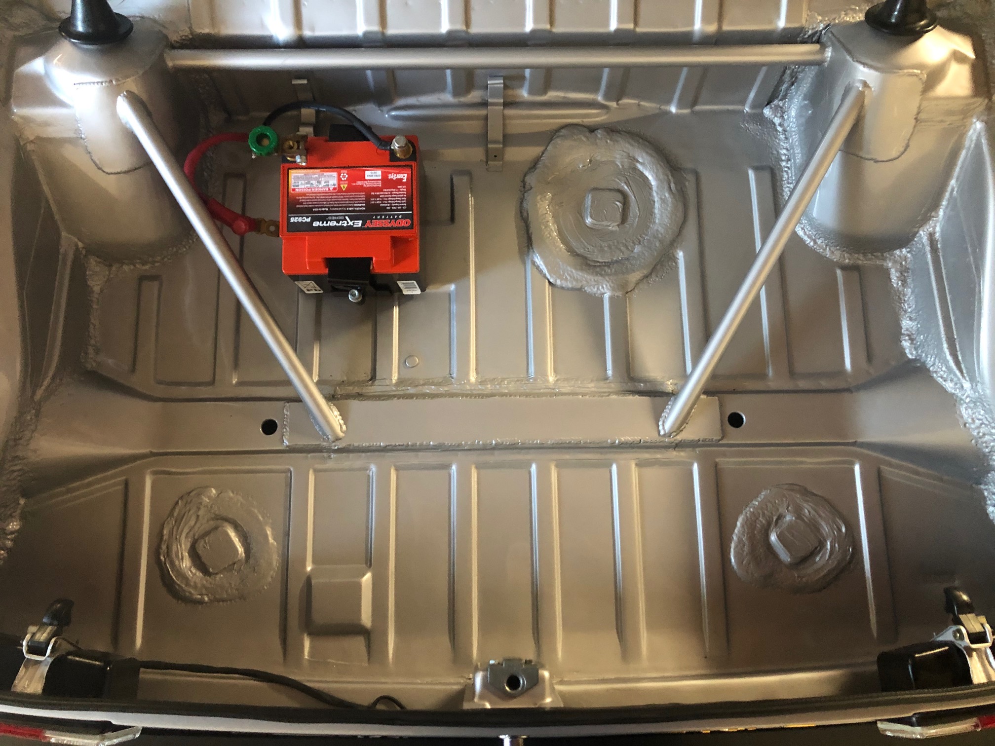

QUOTE(rgalla9146 @ Jul 22 2020, 07:56 AM) *
You've still got a rear trunk right ? man that's beautiful
Yes (IMG:style_emoticons/default/shades.gif)
