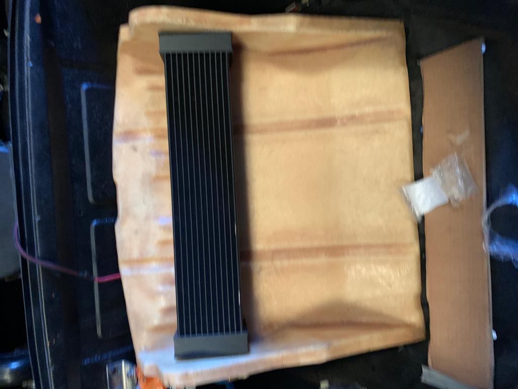

Thanks for the continued references everyone. PMS Setrab unit arrived yesterday and it's a 'perfect' fit inside the should. Now, I'm eager to see how I will need to cut and modify the fiberglass to accommodate the inlet/outlet fittings. Not sure if I should create a small 'box' on the side, or notch it so that it slides on-and-off.
For those interested in the Setrab unit, a few basic dimensions for you regarding sizing....
Overall length: 21-7/8" (22" with included fittings)
Overall height: 4-5/8"
Cooler width: 1-7/8" (3-3/8" with the brackets)
For those of you that have a similar solution, this thread would be very helpful to see how the hoses enter / exit the shroud and any suggestions on fan wiring. I've purchased 2x Spal 4" pullers fans, and the plastic tabs to mount them directly to the cooler; I plan on linking to it in my blog. Looking at you all, @eric9144 and @Marv's3.6six
