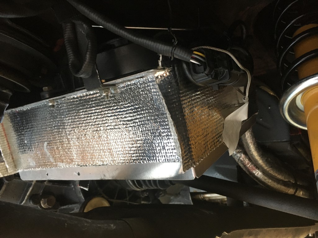

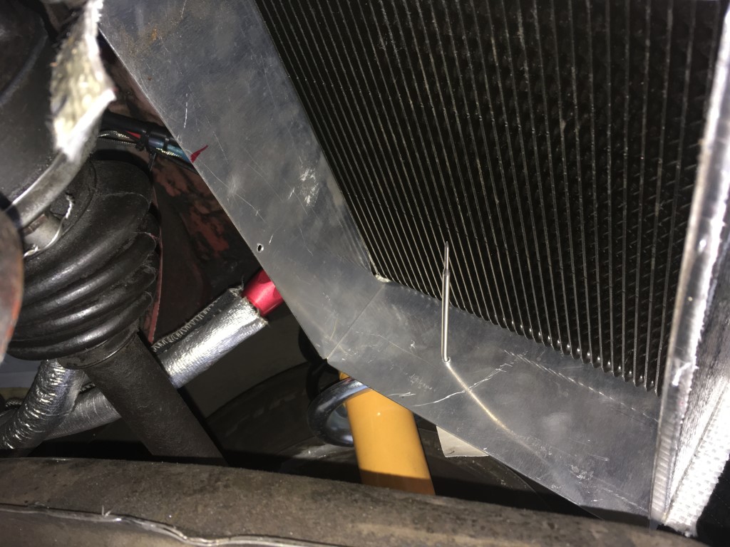

Tonight's tests, removing the duct. Probe is in a hole I drilled on the side of the enclosure that comes with Tangerine's cooler:
Conditions: ambient 84F, sun going down so also low on the horizon like last weekend (but of course on the other side of the car... (IMG:style_emoticons/default/wink.gif) ). Same route, slight descent toward the Sound, then reverse course for a gradual climb home.

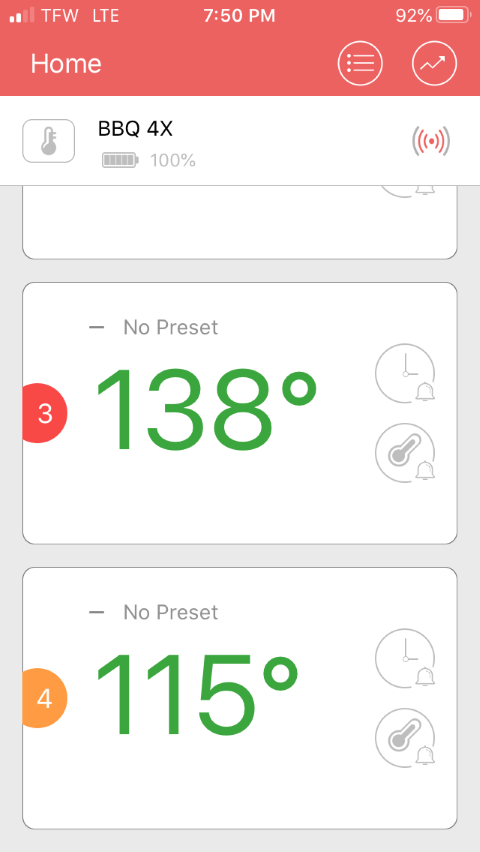

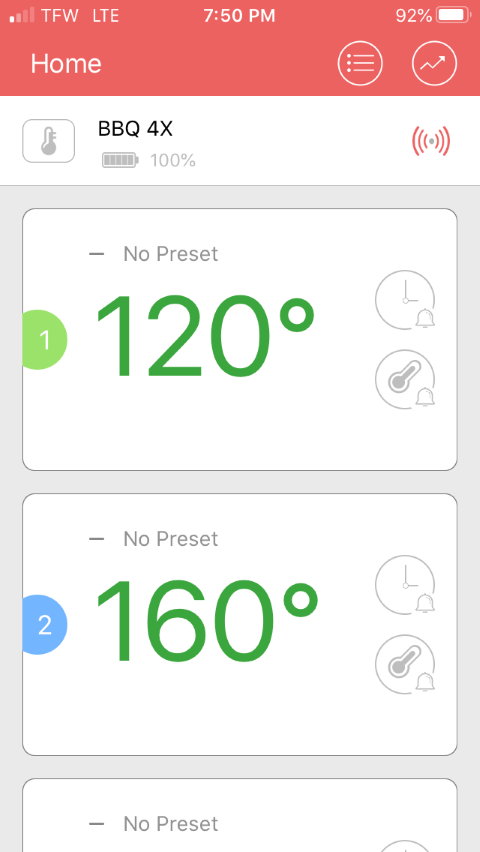

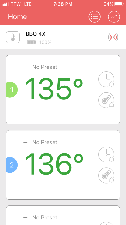

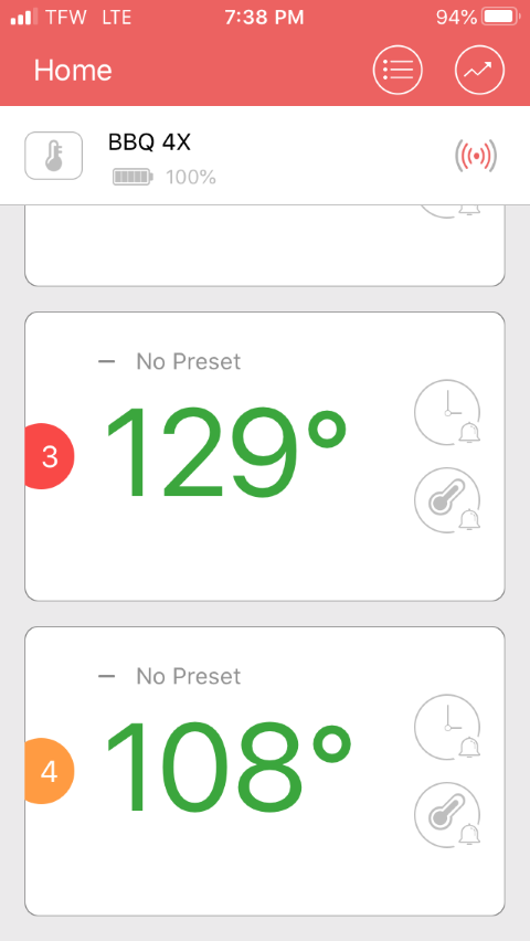

After the thermostat opened, right before the fan kicked on:
After the fan kicked on and all temps were stabilized. Oil temp was at 214F:

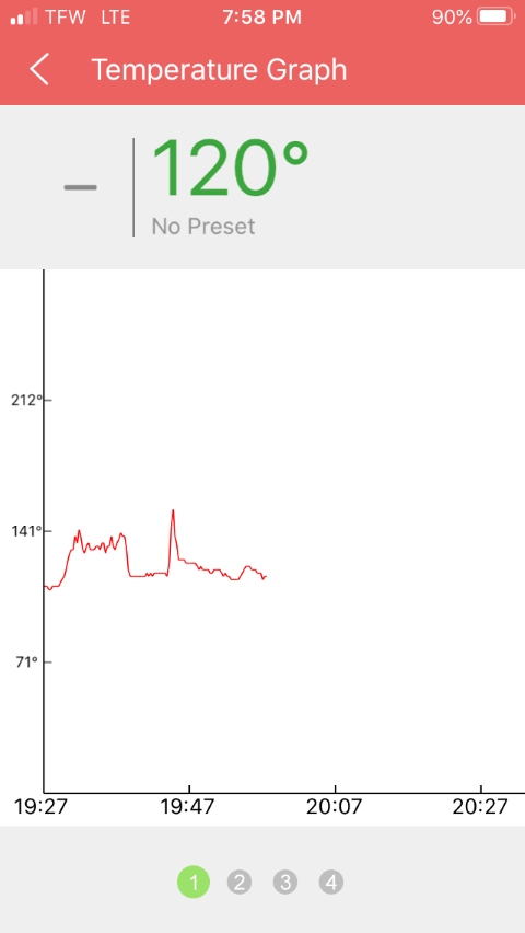

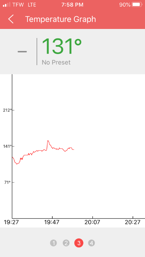

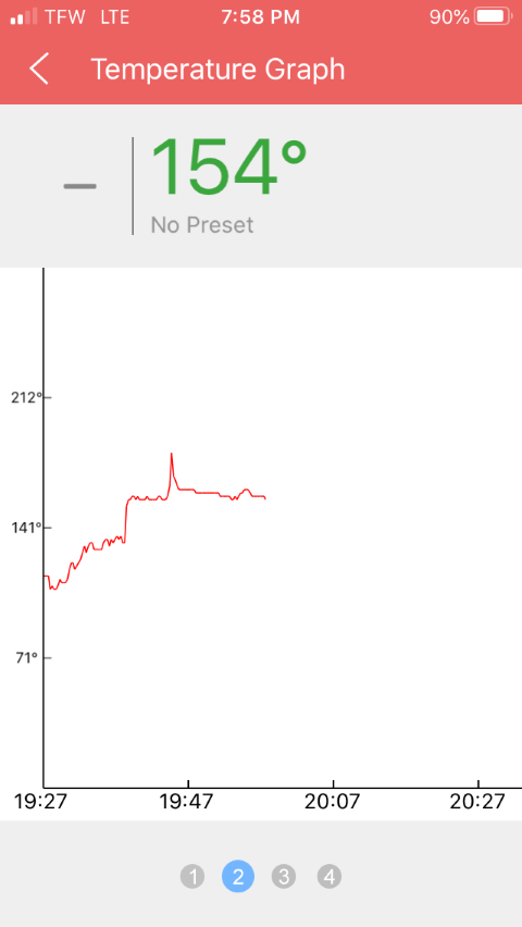

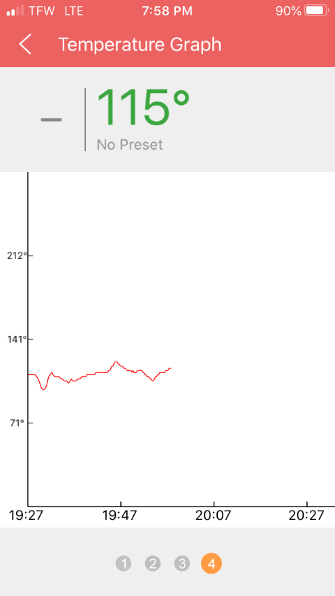

All four graphs:
Spike is when I pulled off the highway and worked my way back around to the other direction.
Conclusion? My intake duct was a bust, made the problem worse.
