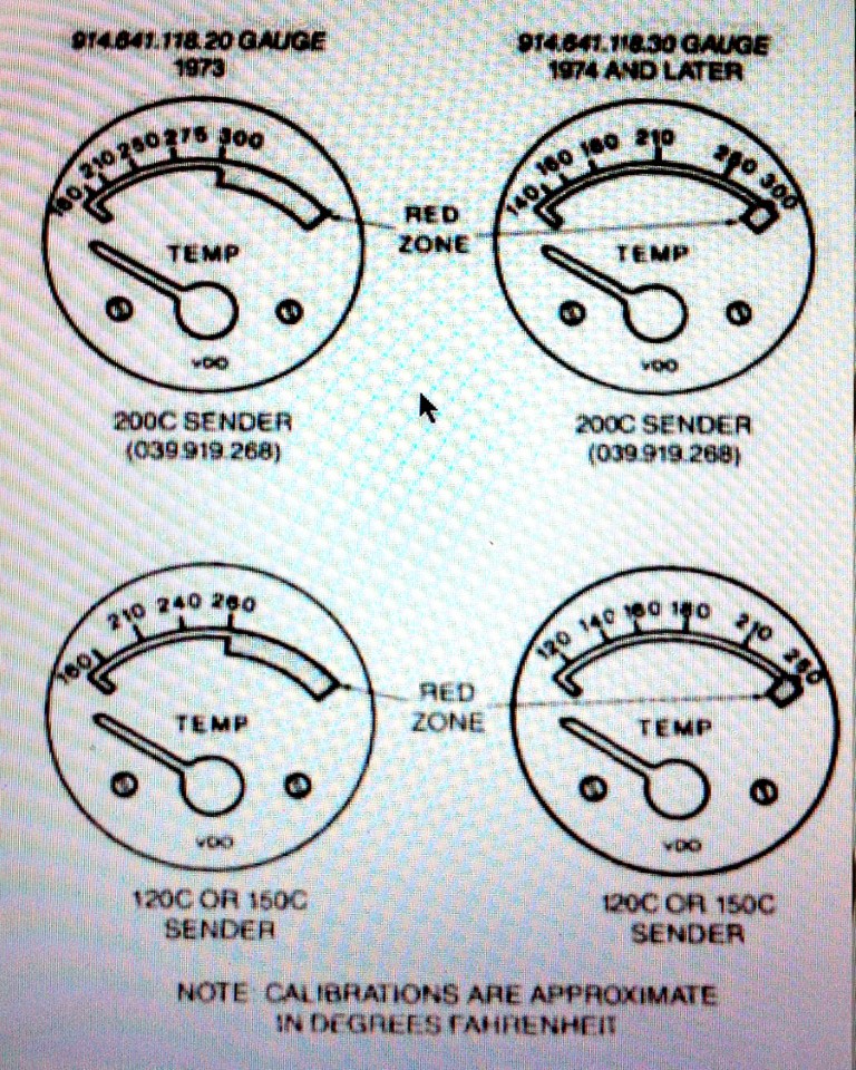

These were all measured via the Mainely dipstick, and correlated to the factory oil temp gauge using the common JPG we've all seen for what the temps are on that gauge.
