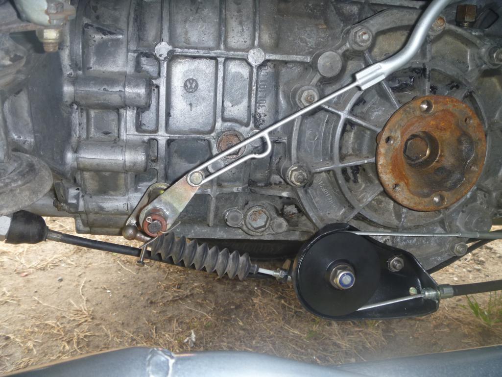

914 Guru ![]() ![]() ![]() ![]() ![]() Group: Members Posts: 5,189 Joined: 25-July 15 From: New Zealand Member No.: 18,995 Region Association: None |
Looking for recommendations on the following: Throttle linkage(Rich's type setup) Oil cooler 90 mod *Note I am unable to buy from Rich Throttle linkage ?? if you are carefully you can drill the g/box and fit a 911 pivot stud and bellcrank assembly,some mods involved but mine works for $100 outlay including curved rod to carbs. Mines ''ass about face'' but works fine. |
