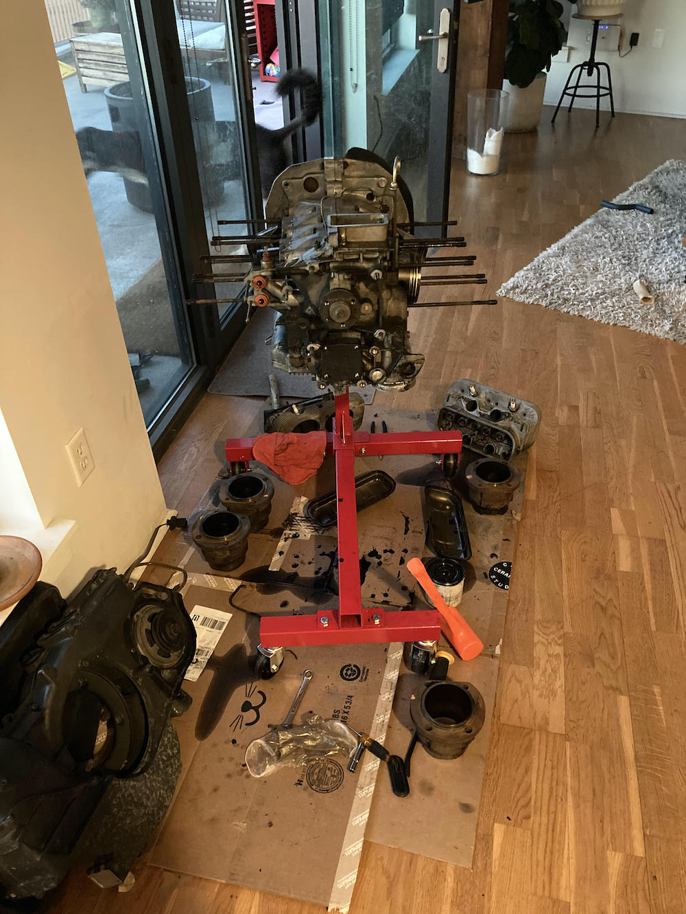

I'm well on my way towards splitting the case and still no sign of where the metal originated from. I am hung up on removing the pistons now and stopped for the night
1) can anybody recommend a good set of snap ring pliers? The ones I purchased at Harbor Freight dont seem to apply enough pressure to remove the snap ring. Is it easiest to use the straight or 90 degree attachment?
2) do i need to label cylander heads when I put them away. Understand most other components it's critical to label, but unsure if that matters here.
The house is much dirtier than I promised my girlfriend, and hoping to have this motor completely broken down this week. Then time to break down the other motor and see if it's a better starting point
