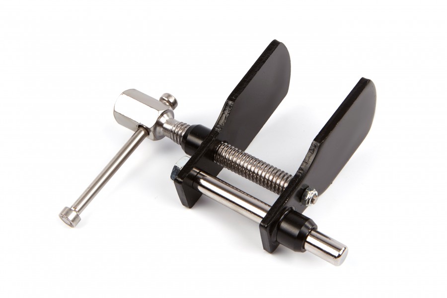

So I've got the car running pretty well, but as I was driving I noticed some front end vibration on the passenger side. Upon pulling the wheel, I noticed the hub is not turning completely freely....the pads seem to be rubbing.
I pulled the retaining pins, spreader springs, and removed the pads and piston retaining plate. Upon doing that, the hub has no slop/play, and the wheel spins very well. So, while I realize that I should ultimately pull the calipers and send them to PMB for a full rebuild(and probably will soon), right now I would like to only replace the pads, spreader springs, and piston retaining plate. While I'm sorting the car, I'm going on very short runs on very isolated roads. Anyhow .....my QUESTION is related to the step in both the Pelican Article and Haynes Manual where it states "Now, using a plastic handle, or a piece of wood, push both the front pistons back into their housings. " This is step before re-installing the pads. I'll take a closer look today, but yesterday I didn't notice where the piston is protruding out very much into the space between the caliper and the disc....if this make sense. So, in this tight space, with the caliper still on the car, is there a specific tool/method of pushing the piston back in? Any techniques or tools to accomplish this task would be appreciated. Thanks! |

working on my first 914 ! ![]() ![]() ![]() Group: Members Posts: 653 Joined: 13-April 16 From: Holland, the Netherlands Member No.: 19,896 Region Association: Europe |
In have this one. Works well. Cheap tool, and since I do not use it daily, the quality is good enough.

Tdskip C-clamp is often used. Make use you don’t overfl... Aug 8 2020, 05:44 AM
terryth I use a tool like this after the caliper is off
ht... Aug 8 2020, 05:51 AM
Frankvw if you have no good space while the caliper is sti... Aug 8 2020, 06:59 AM
Craigers17 Thanks for the tips....I think pulling the caliper... Aug 8 2020, 07:21 AM
Tdskip Let us know how it works out . Aug 8 2020, 07:22 AM

GregAmy Ratchet style is the cat's meow. Aug 8 2020, 09:06 AM
Craigers17 Just to add a quick update to this thread. I purc... Aug 26 2020, 09:53 AM
