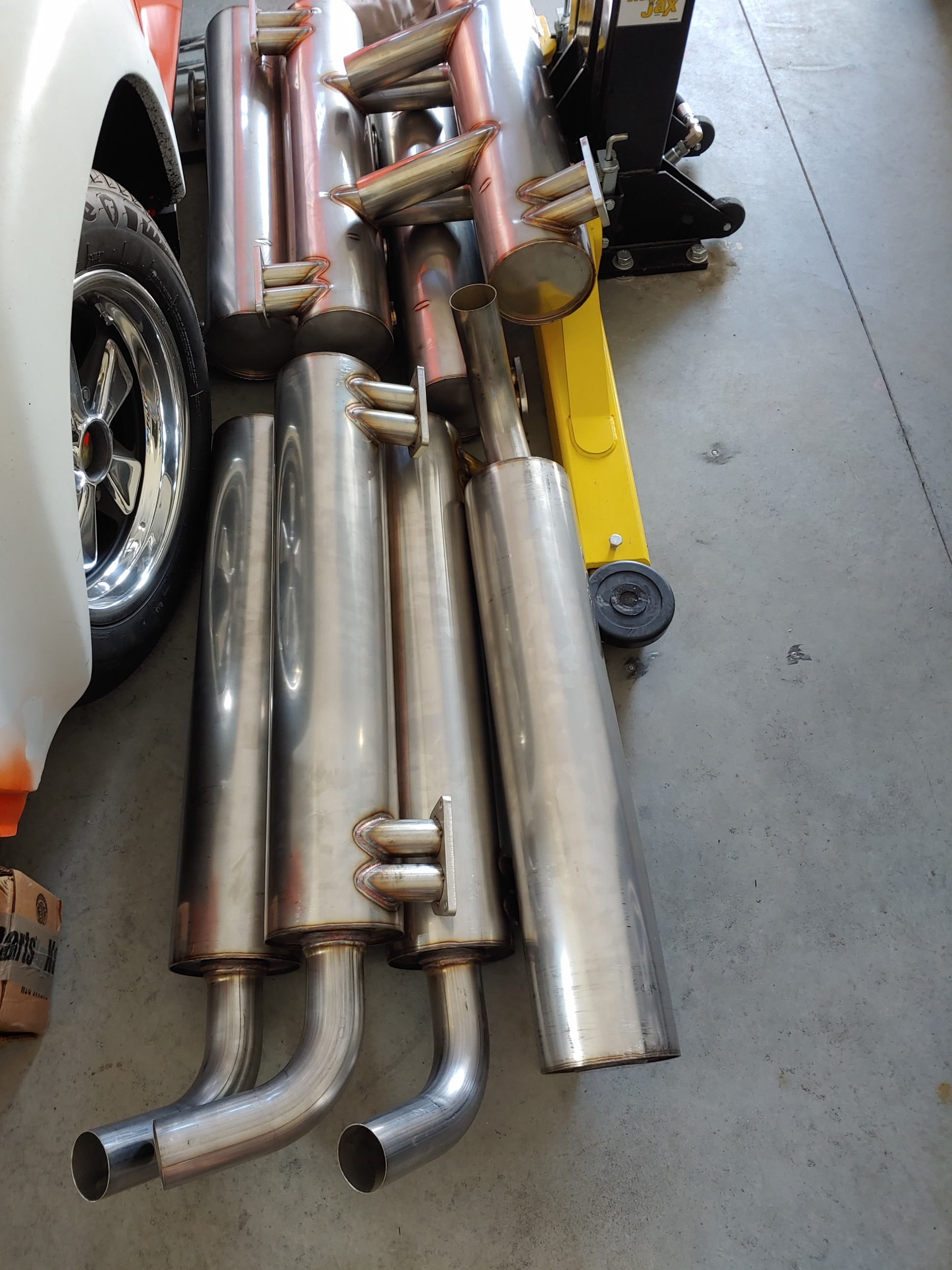

mb911   Not the most flattering picture there of the garag...   Aug 19 2020, 05:48 PM
JmuRiz   Not the most flattering picture there of the gara...   Aug 20 2020, 07:18 AM
