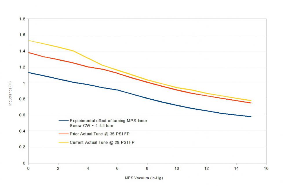

As you can see in the "Chart A" sketch above, the MPS Inner Screw (in isolation), Outer Screw+Inner Screw (together), and Stop Plug Screw can be used to tune the MPS's affect on the AFR (via its effect on the Fuel Injection pulse width) vs Manifold Vacuum. As shown, the Inner Screw affects the mixture over the whole vacuum range; the Inner+Outer Screw controls the onset pressure P' where the diaphragm begins to lift off the part-load stop; the Stop Plug Screw controls the final pressure P'' where the diaphragm comes to rest on the full-load stop. On this chart, "up" corresponds to a longer FI pulse; "down" to a shorter FI pulse. For details, see pbanders's excellent link, above.
I had previously thought that the effect of the Inner Screw was similar to that of changing the fuel pressure via the fuel pressure regulator. Namely:
Inner Screw CCW = Increase Fuel Pressure => Richer AFR across entire vacuum range
Inner Screw CW = Decrease Fuel Pressure => Leaner AFR across entire vacuum range
There appeared to be no way to change the slope of the MPS Response curve in the region from 15 In-Hg to P'. And, I was experiencing the same problem that Demick posted about years ago in the thread linked above. Namely, the AFR would become too lean under moderate-load conditions across all RPM's, like this (from Demick's post):
(IMG:http://www.914world.com/bbs2/uploads/post-2-1096387565.jpg)
To fix the lean condition around 6-8 In-Hg, it's really necessary to change the slope of the MPS response curve, not just raise or lower the whole curve.
However, there appears to be hope. It seems that the MPS inductance is not simply linear WRT manifold pressure in the 15 In-Hg to P' region. I speculate that this may be due to non-linearity in the MPS Inductance across its range of movement and/or the effect of the MPS spring. The result is that the curve seems to look more like the "Chart B" sketch above. And, the effect of turning the MPS inner screw isn't really raising or lower the entire curve, but rather shifting the Chart B curve left/right. (Chart B is a really rough sketch, and may even have the convexity backwards. For a more quantitative look, see below.)
I measured the inductance of my MPS at two different inner-screw settings: The red curve is the MPS tuned to pbanders's values corrected for 700 Torr ambient pressure. The blue curve represents an attempt to richen the AFR by turning the inner screw CCW.
As you can see, the slope of the red curve is steeper than the blue curve in this region. Apparently, turning the inner screw CCW has the effect of reducing the slope by raising the right end, rather than raising the whole curve.
I'm surprised that the curves cross around 7 In-Hg and that the blue curve value is less than the red curve value at the left side of the chart. This may be due to the effect of the part-load stop coming into play near P', measurement error, or something else. (IMG:style_emoticons/default/confused24.gif)
The salient point, however, is that adjusting the inner screw affects the slope of the curve, whereas presumably adjusting the fuel pressure does not.
The opens the possibility of tuning the AFR vs Manifold pressure curve by trading off fuel pressure vs inner screw position:
Increase Fuel Pressure + Turn Inner Screw CW => Enrich 6-8 In-Hg region
Decrease Fuel Pressure + Turn Inner Screw CCW = Lean out 6-8 In-Hg region
I experienced the same problem that Demick did (too lean at 6-8 In-Hg across all RPM), and have largely solved the problem by adjusting the fuel pressure up (to 35 psi currently), then tuning the MPS to set the AFR across the entire range of manifold vacuum levels.
I hope this is helpful to somebody. Comments are welcome. If I've made any errors, please feel free to beat me over the head. (IMG:style_emoticons/default/splat.gif)

*** UPDATE ***
I was bothered by the Inductance vs Vacuum graph in my OP (the one with the red and blue lines). I couldn't explain why the red and blue curves crossed at around 7 In-Hg. I also wanted to illustrate how to determine P' and P'' from the graphs. Finally, Olympic914 asked why the graph didn't go all the way to 0 In-Hg.
So, I took some more data. I'm at 2250 ft elevation (700 Torr), and its about 90F in the garage today. The red curve in the graph below shows my actual current MPS tune. The blue curve shows the effect of turning the inner MPS screw (in isolation) one full turn CW. The blue curve is just an experiment to see what would happen to the MPS response -- it doesn't represent any kind of useful tune. I also graphed the data all the way down to 0 In-Hg to show the WOT part of the response.
At first glance, it appears that turning the inner screw CW just lowers the whole curve. But, if you "raise" the blue curve by adding an offset so it starts at .750H at 15 In-Hg like the red curve, the difference in slope becomes clearer:
P', where the MPS diaphram begins to lift off of the part-load stop, and P'', where the diaphram hits the full-load stop aren't readily visible with this particular tune because their effects on the slope are too small to see here.
As to the crossing traces in the OP, data for that graph was taken on different days with different tunes. So, maybe the effect of the outer screw and/or plug affected the values. Maybe it was a difference in temperature or barometric pressure on those days. Maybe it was a measurement error. I dunno. (IMG:style_emoticons/default/confused24.gif)
Finally, the graph in my OP appeared to show that turning the inner screw CW would make the slope of the response curve steeper and thus:
Today's data shows exactly the reverse -- turning the inner screw CW appears to reduce the slope of the response curve. Hence:
Increase Fuel Pressure + Turn Inner Screw CW => Lean out 6-8 In-Hg region
Decrease Fuel Pressure + Turn Inner Screw CCW = Enrichen out 6-8 In-Hg region
So, I dunno. I may reduce my fuel pressure back to 29 psi and retune the MPS to see the actual in-car driveability effects. If anybody else wants to post data from their own MPS's, that might be useful.
Cheers. (IMG:style_emoticons/default/beerchug.gif)

Subscribed...
I`m on vacation right now and don't have access to my MPS tuning data, will post later (3weeks from now).
1. Make sure that Full Load Stop does not influence your data. So remove Full Load Stop to record Part Load and Part Load to FullLoad tranition area. Latest data look much better/correct.
2. IN Chart A, P" arrows should go up and down versus left and right, I think
3. Fuel pressure should be limited to a maximum of 33 PSI as Injectors do not operate reliable above (stay open at max duty cycle, causing very rich mixture at above 5200 RPM)
4. Yes, engine leans out at higher part load RPM and if you compensate you will end up pig rich at coldstart, idle and blow max. torque (3000 - 3100 RPM) and overrun, rest can be tuned almost perfect.
So, I think you need to touch ECU internals (uplift the idle pot. capability and tue the RPM range between idle and max. torque and keep us posted...)
5. I'm just trying to gather data for volumetric efficiency for almost the same engine with Megasquirt and to translate/mimic it to D-Jet ECU later
6. I think the 0043/0044 ECU will be easier to tune as you have a better mechanical range of the MPS available
Take care,
Frank

Awesome insights! Thanks, Frank. Please see my comments below in italics.
QUOTE(Frank S @ Aug 18 2020, 11:06 AM) *
I believe that the Full Load Stop (Let's call it the "FLS") should only affect the curve in the region from P'' to 0 In-Hg, unless there is some subtle effect at other pressures that I don't understand. What say you? (IMG:style_emoticons/default/confused24.gif)
The position of the FLS sets the mechanical distance that the diaphram can move between the Part Load Stop (PLS) and the FLS. You can find that actual distance by measuring the number of FLS turns from its limit at the PLS. The screw has a 1mm pitch, so a full turn CCW from the PLS corresponds to 1mm of diaphragm travel. IIRC, pbanders estimated the stock distance to be around 1.3mm (on some MPS variant, at least). FWIW, thanks to the Tangerine kit, I can turn the FLS with a hex key, and I count hex "flats" (1/6 of a turn) to determine the distance when tuning.
On Chart A in the OP, this diaphragm travel distance corresponds to the delta-P between P' and P''.

*** UPDATE ***
Based on the data from post #17 and Frank S's suggestion, I lowered my fuel pressure to 29 PSI -- basically going from the high extreme to the low extreme to try to exploit the differences in the slopes of the curves to compensate for an over-lean condition I was seeing under moderate load (about 8 In-Hg).
I re-tuned the MPS and adjusted the idle knob for the following AFRs:
Hot Idle: 12.0
Hot Cruise 13.0
Hot WOT 11.5-13.5
Notes:
1) Today was 90F out, so I may make some further adjustments if/when I can test at a cooler temperature.
2) My idle AFR is a bit richer than I would like, but I'm running into a heat-soak issue after dropping to idle immediately after a hard WOT run, where the car would sometimes stall.
3) My "cruise" AFR is still a bit rich at low load to keep the mix from going too lean at moderate load (about 8 In-Hg). Note that this tendency to go lean at 8 In-Hg, pretty much across all rpms, was what prompted me to start this thread and explore the MPS slopes.
4) This current MPS tune reflects changes I made to the VE curve inside the ECU, as I was having a problem where the AFR would go too lean at around 4600 RPM, WOT. The WOT AFR still varies across RPM, and is a bit lower than I would like at 3000 rpm (11.5) and a bit higher than I would like at 4600 rpm (13.5), but it is much improved after modifying the ECU.
5) Driveability is excellent. It idles well. There is no noticeable surging or flat spots across all loads and RPMs.
The yellow curve in the chart above is my latest MPS tune, after lowering the fuel pressure to 29 psi, and modifying the ECU.
Note that the yellow curve has the highest slope of any so far in the region from 5-15 In-Hg, and represents my best effort yet of reducing the lean spot at 8 In-Hg.
On the yellow curve, you can also see the "knees" corresponding to P' at 5 In-Hg, and P'' at 3 In-Hg. (P' is set by turning the inner and outer MPS screws together. P'' is set by turning the Full-Load Stop Plug screw.)
EDIT: These MPS inductance values are at 700 Torr; they have not been corrected to sea level.
I'll start another thread with details on my ECU mod.
[color=#3366FF]

This thread is great.
Did you happen to break out the difference in dropping the fuel pressure and the latest MPS tune, before making the ECU mods?
Waiting to see what you can change inside the BOX...
I have an 044 ECU sitting in the wings but I'm not sure I want to go through the route with retuning the MPS for that one..
