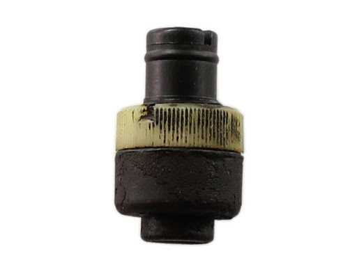

What would it take to get one of our vendors to make these?
022115542 - crank case valve
Surprisingly critical part for proper operation on 72-74 djet cars, not just for crank case venting but has a large impact on idle control and how d-jet runs. Supposed to be a regular maintenance/replacement item as well yet they haven't been available for close to 20 years. Struggling to find any that don't result in some sort of idle control issue these days.
Less critical is the associated nut 022115544

Can you post a photo?

Mikey914   Happy to take a look at these this next week. I...   Aug 20 2020, 12:03 AM

Mikey914   Ok, Had started drawings on this, but if URO wants...   Sep 14 2020, 01:07 PM
second wind   So...is there a good way to service these little s...   Sep 14 2020, 05:45 PM
second wind   Cleaned my existing one.....seems to function just...   Sep 17 2020, 10:58 PM

second wind   Well...I said I would report back not that anyone ...   Sep 18 2020, 05:33 PM
Mikey914   I'm happy you were able to resolve the problem...   Sep 19 2020, 06:39 PM
UROpartsman   Mark says his valve isn't in the best conditio...   Sep 22 2020, 01:17 PM
UROpartsman   We found a good sample, thanks guys. Currently ev...   Nov 12 2020, 03:49 PM
