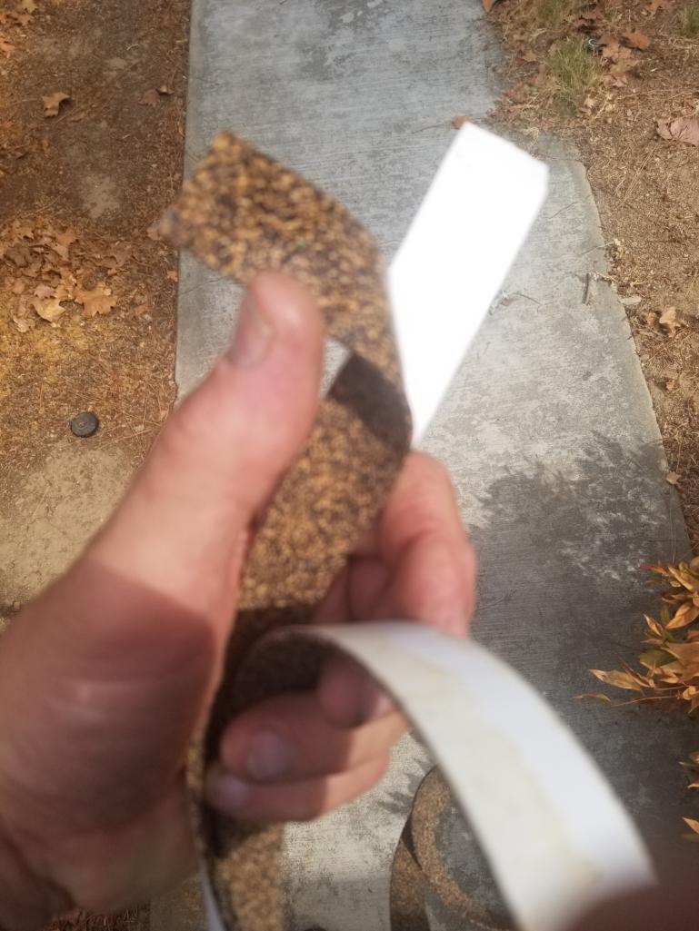

I have never seen a gasket in that location and there is not much gap for one.
I got the 1" x 1/16 rubber cork gasket material. It was $10 for a 100 ft roll. I am going to try a piece there.
