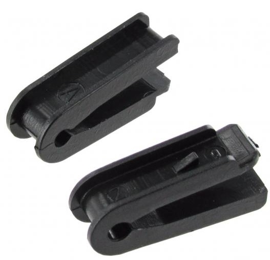

914_7T3   Anybody know if this is the correct clip? If so, ...   Mar 2 2020, 11:32 PM
DRPHIL914   Anybody know if this is the correct clip? If so,...   Mar 3 2020, 08:03 AM
bbrock   Here are the clips I just took off my 30+ year old...   Mar 3 2020, 09:09 AM
914_7T3   V..........Victory!   Mar 8 2020, 06:09 PM

914_7T3   So...what was the final answer? Found them at o...   Mar 8 2020, 08:06 PM
