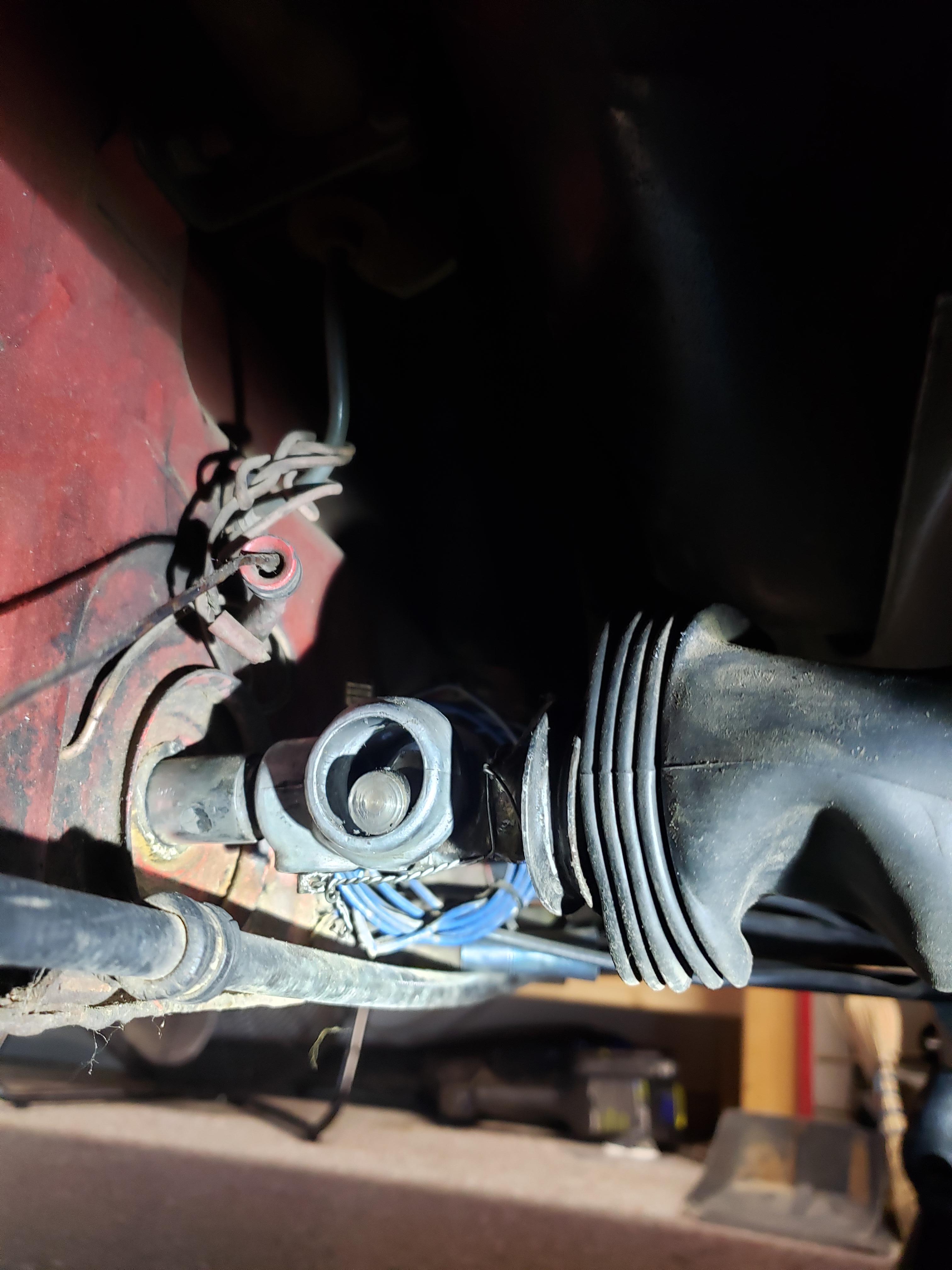

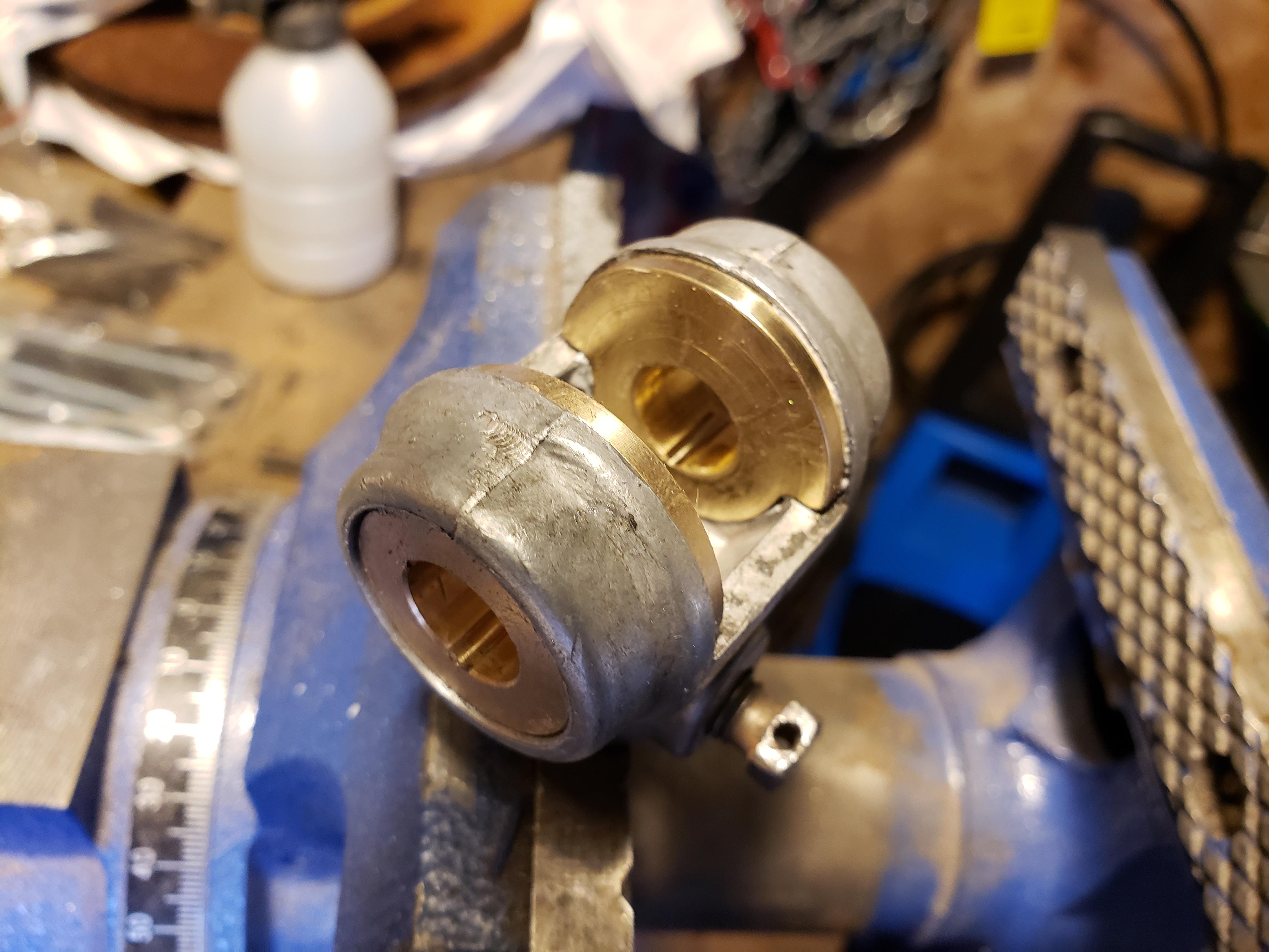

On one drive, I suddenly lost the ability to shift into 4th and 5th. Could this be the culprit?
Better:

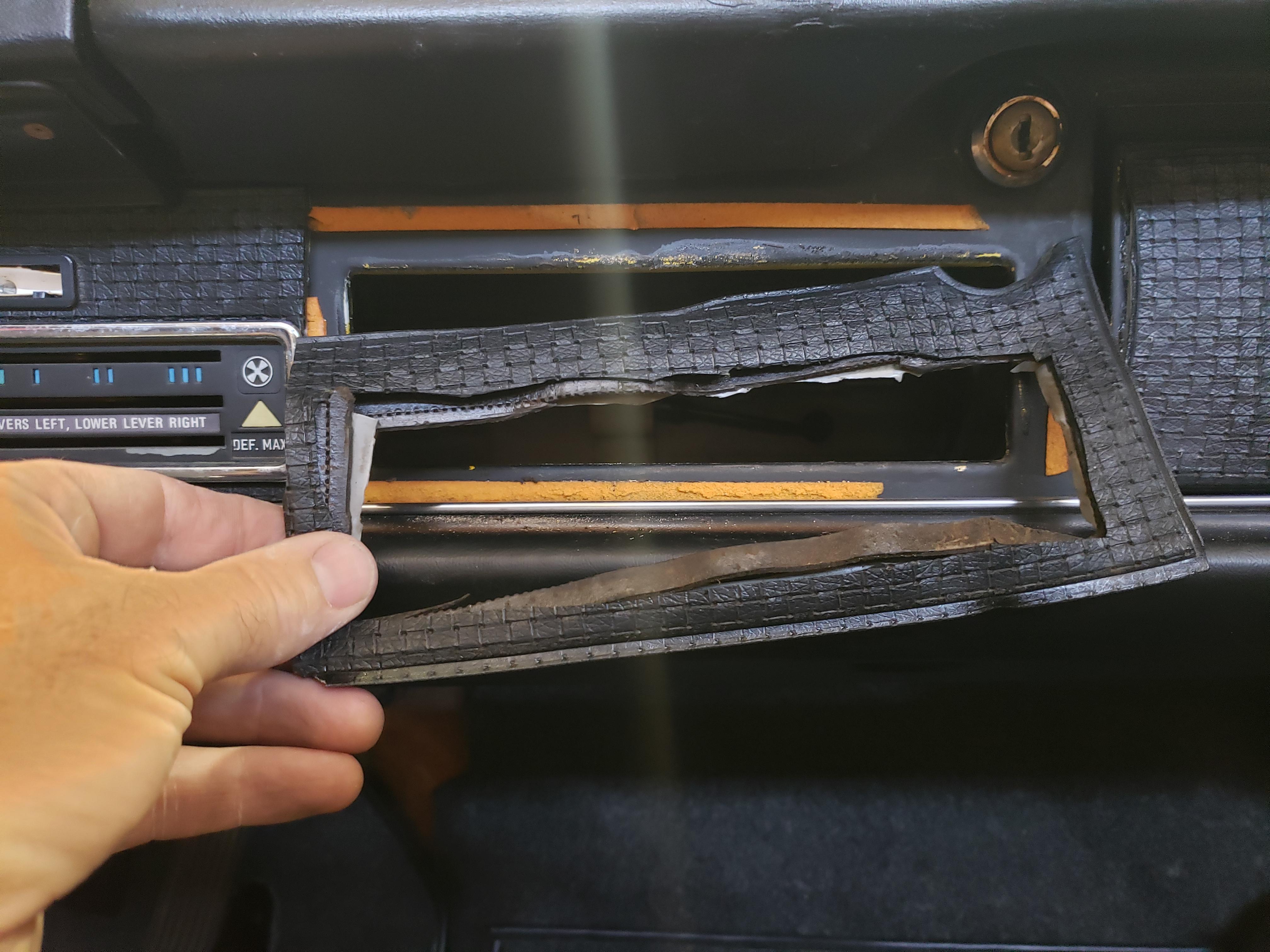

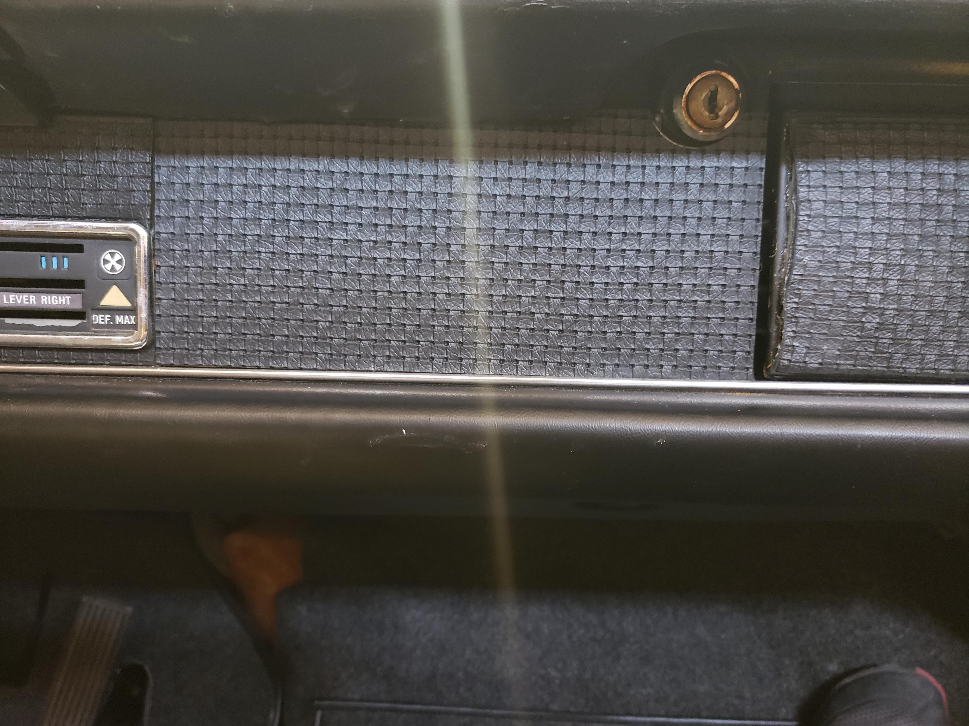

Also got a radio blank-off plate from 914Rubber:
Best wishes to all!
