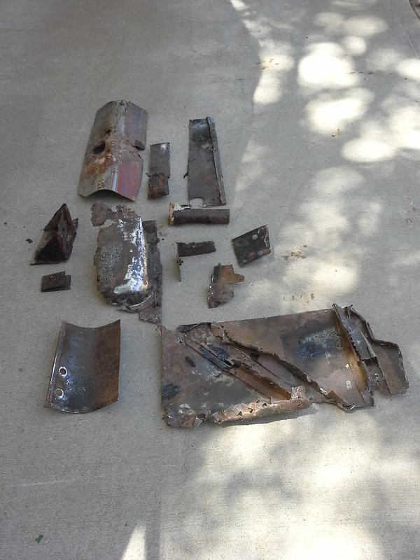

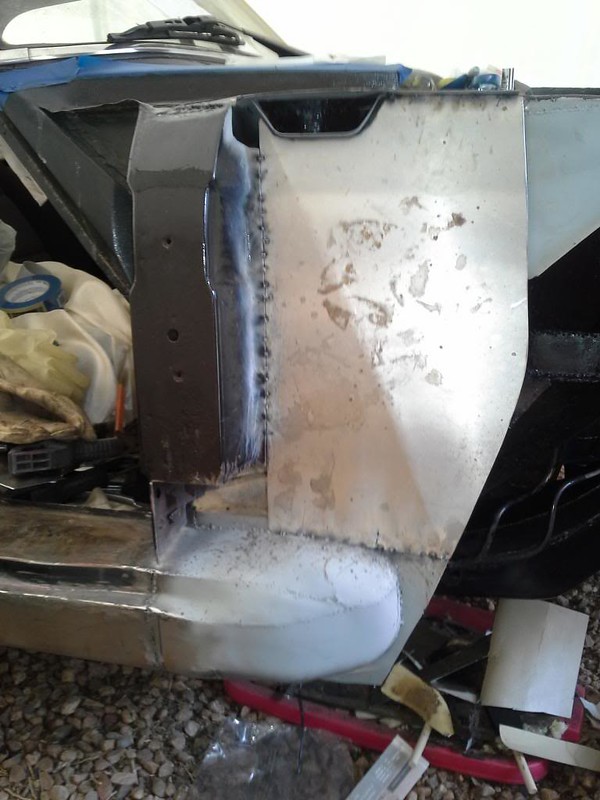

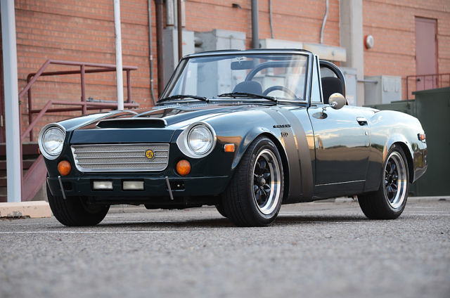

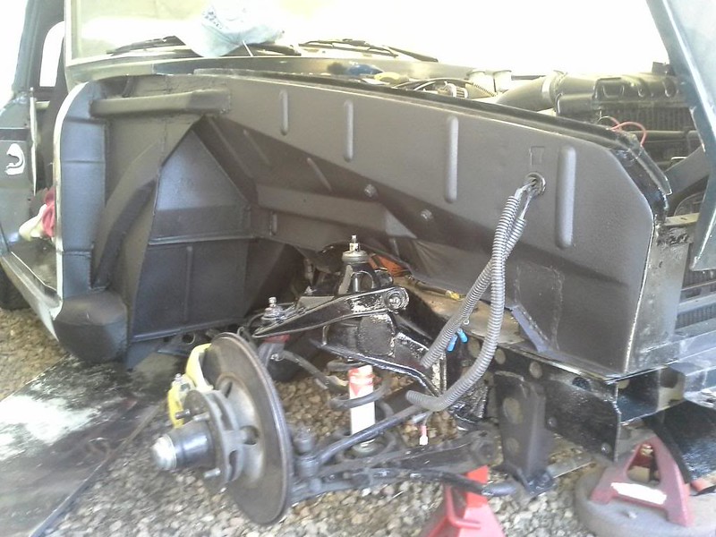

I understand! It kind of made me cringe to do these half-assed fixes. I did a lot of rust repair on my old Datsun Roadster, so I know how satisfying it is to do it right.
70 Datsun Roadster inner fender repair:
On the 914, they were temporary stop-gaps so I could use the car some and I didn't want to rush a welding job. I want those repairs to be high quality when I get to them. Thanks for the comments and encouraging words!
