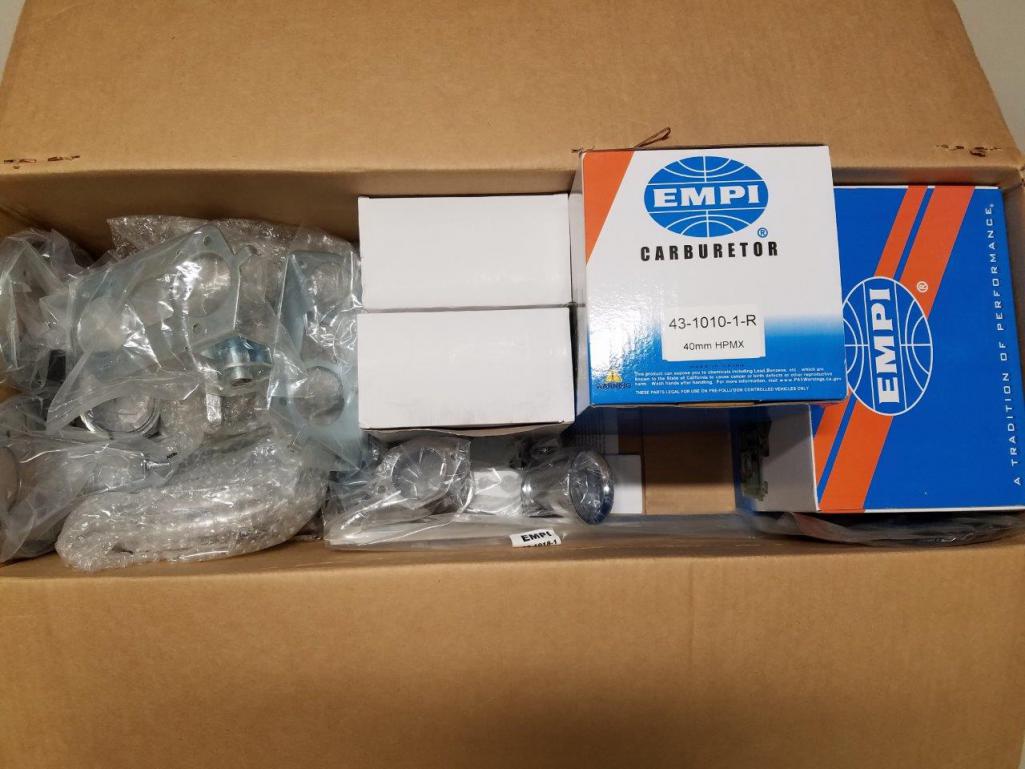

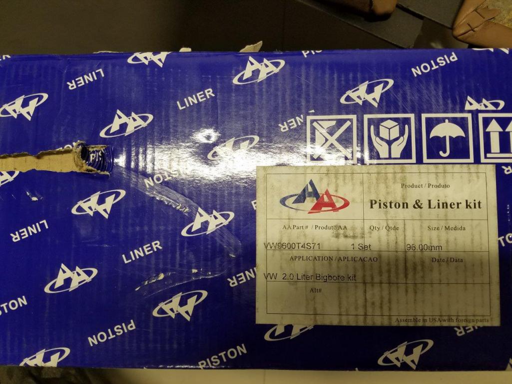

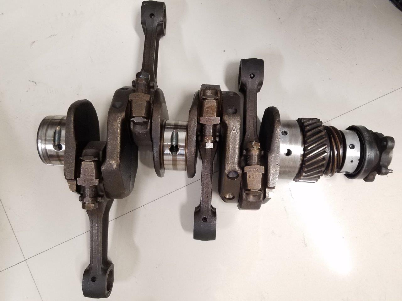

When I bought the car I did not find out until later that it came with some 40 Dual Carbs, a set of 96mm pistons and a 2.0 crankshaft with rods. The guy I bought it from called me up and said that I had forgotten some parts and to go pick them up. Imagine my surprise when I saw what they were. Now my engine is a 1.7 but I will need to rebuild my heads and get bigger valves for them. Hope you guys can let me know who I should take them to here in Southern California.
