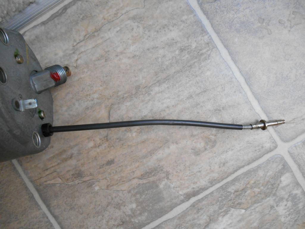

Hi again, I have taken it out without removing the steering wheel, I had the wheel off once to put the stock one back on did not really want to take it off again. I disconnected all the parts BUT had one problem I did not see where this long cable went into when I pulled it out see pictures. Can anyone offer assistance on where it plugs back into?Attached Image

That is the trip meter re-set cable for resetting the trip meter to zero. It goes into a hole in the bottom of the dashboard. It’s missing the re-set knob, washer and retaining nut.
