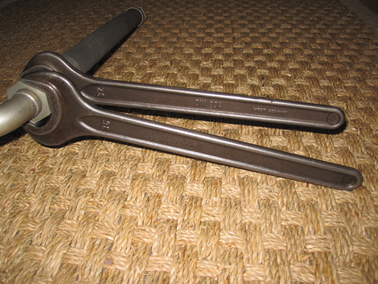

Bought one of the Rothsport oil valves because I was tired of cleaning up oil after taking the car out. Installing it was my weekend project (what did you do to your 914...?) Had the pull the heat exchanger, and the hose connection at the oil cooler came off surprisingly easy. The connection at the U bracket is another story. It hasn't been loosened in at least 30 years and having no luck breaking it loose. Any suggestions?

In your photo both sides are steel, the aluminum is a collar.
Arrange the wrenches as close to photo as possible and squeeze.
If necessary heat the large nut with a torch. 36mm and 32mm is correct.
Stoddard sells a four wrench set 27,30,32,36 mm reasonably priced.

Appreciate the photo, I'll give it a try although a little trickier when still on the car. So nice and clean-mine is the 50yr old original....
