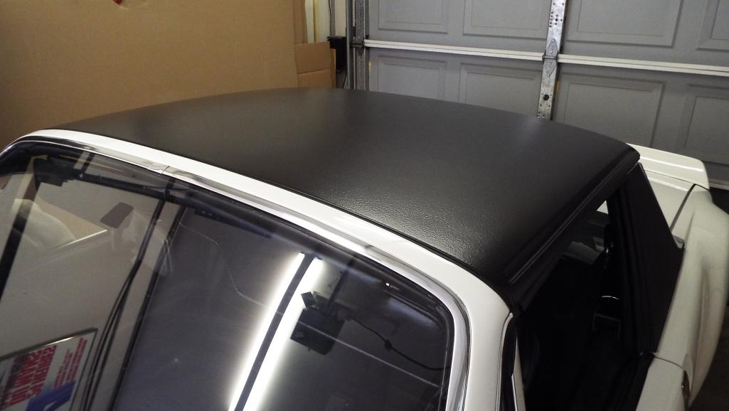

I plant to clean top,not sand. Any recommendations for spray paint choice in black

Had great results with SEM Trim Black. Cleaned top with Prep-sol, no sanding, no primer, just right over the existing texture that was there. Provides a nice sheen but not shiny.
You must keep a wet edge, which is difficult with a rattle can, but can be done. You will need 2-3 coats.
Have received lots of complements on it. Good luck!

That really looks nice! SEM stuff is good.
