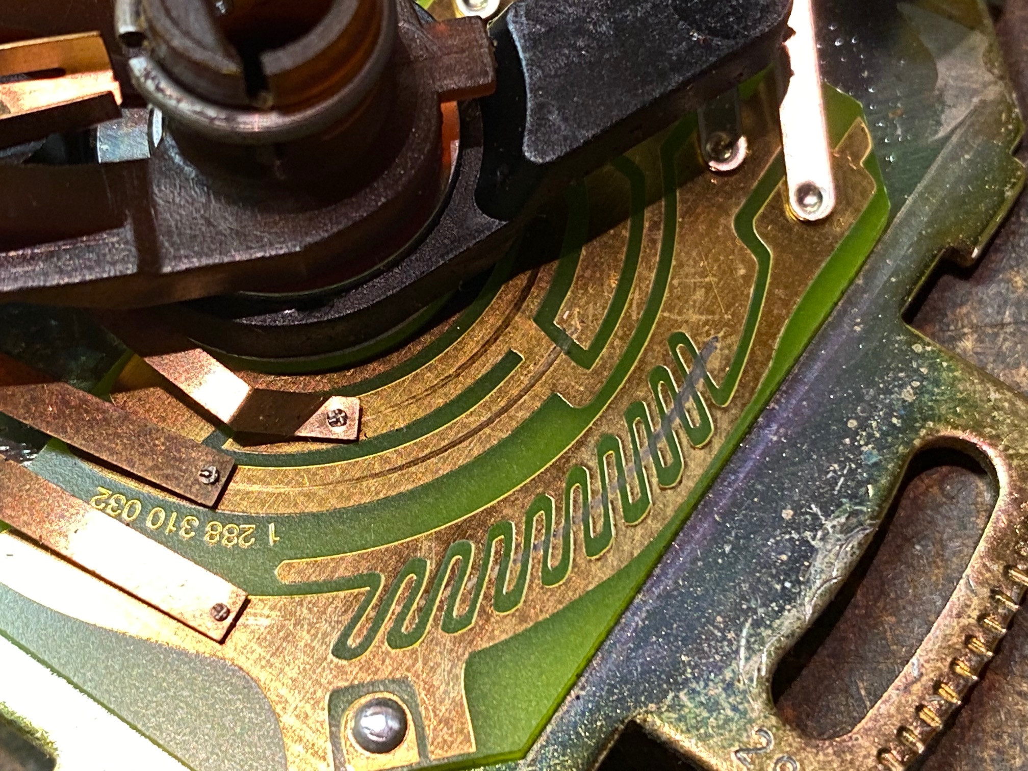

Thank you everyone. I just removed the TPS, which I replaced a few years back (>5 I think).
I will check continuity, clean up with an eraser and then reinstall, adjust and will report back.
I started to clean up the contacts with the eraser...

wndsrfr   Clean the contact strips on the TPS...   Aug 23 2020, 09:25 AM

windforfun   I had a similar problem. I found a new TPS & ...   Aug 24 2020, 11:11 AM
solex   Thank you everyone. I just removed the TPS, which...   Aug 25 2020, 10:35 AM
PCH   Looks like the board is worn out. 914 Rubber has n...   Aug 25 2020, 11:12 AM

solex   I saw the new board, looks great and will order on...   Aug 25 2020, 01:23 PM
solex   I reinstalled the TPS and it was still stumbling, ...   Aug 26 2020, 06:28 AM
