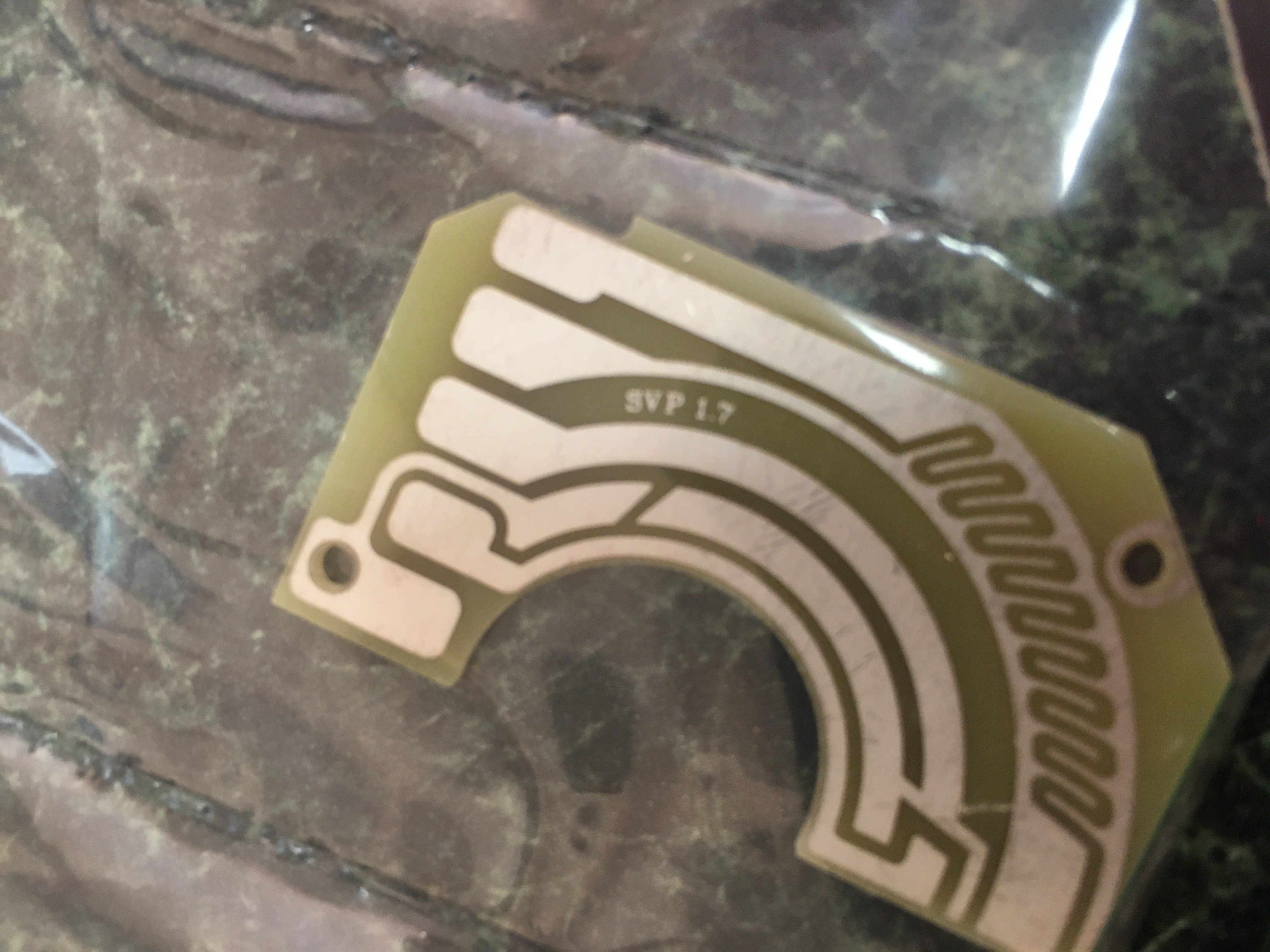

Thank you everyone. I just removed the TPS, which I replaced a few years back (>5 I think).
I will check continuity, clean up with an eraser and then reinstall, adjust and will report back.
I started to clean up the contacts with the eraser...

Looks like the board is worn out. 914 Rubber has new boards.Attached Image
Here is what a new board looks like .
