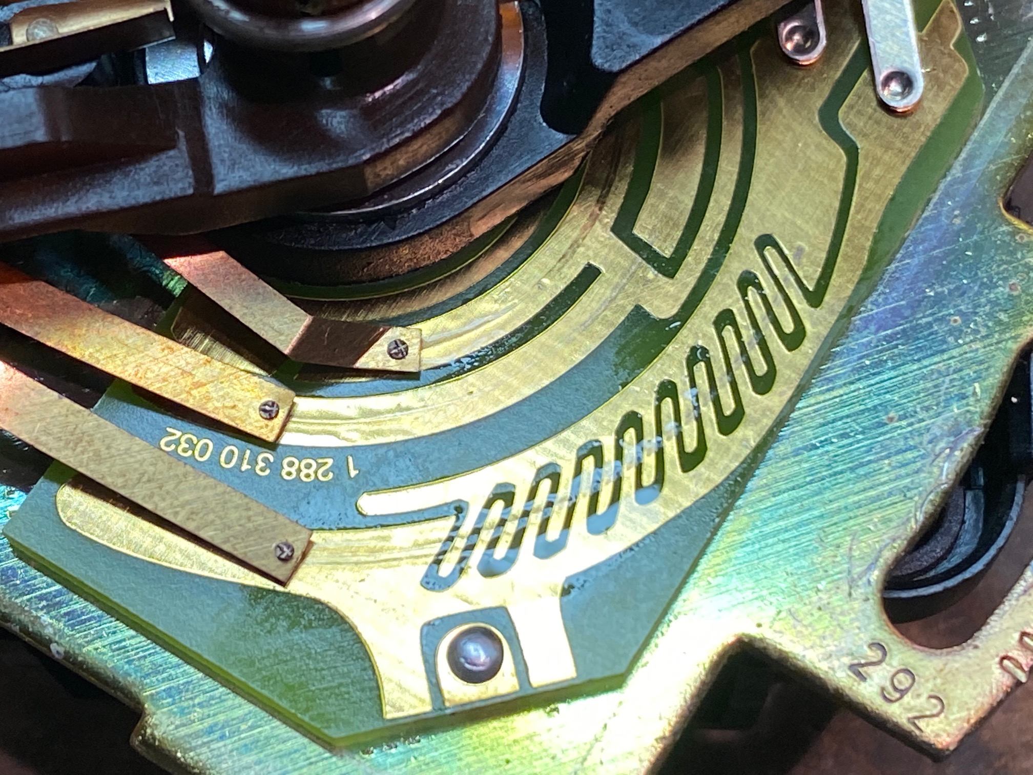

On my past few drives the car has been stumbling when I accelerate specifically when warm and in every gear except first, in my 2.0L D-Jet in a 75'
A few of things to note:
- Ground strap at transmission has been cleaned
- Installed a second ground at battery ground point to the engine fan
- New spark plugs Bosch W175T2
- Engine compression 134-145 all cylinders
- Fuel pressure set to 28 psi
- spark plug new wires
- 123 Ignition curve 2 with vacuum advance attached, 10 degrees advance at idle
- Injectors have been rebuilt by Mr. Injector
- All vacuum hoses have been replaced
- AAR is in working order and has been oiled
Not really sure where else to look, the engine idles < 1000 but is not smooth at times jumping +/- ~ 200 RPM
Any advice would be appreciated.
solex
post Aug 25 2020, 01:23 PM
Posts: 789
Joined: 12-January 05
From: Long Island, NY
Member No.: 3,439
I saw the new board, looks great and will order one for a backup.
I cleaned mine, put some dielectric grease and checked continuity on all contacts throughout the range of the switch and it checked out.
There are no broken contacts and will install and adjust for idle and WOT.

solex   Thank you everyone. I just removed the TPS, which...   Aug 25 2020, 10:35 AM
PCH   Looks like the board is worn out. 914 Rubber has n...   Aug 25 2020, 11:12 AM

solex   I saw the new board, looks great and will order on...   Aug 25 2020, 01:23 PM
