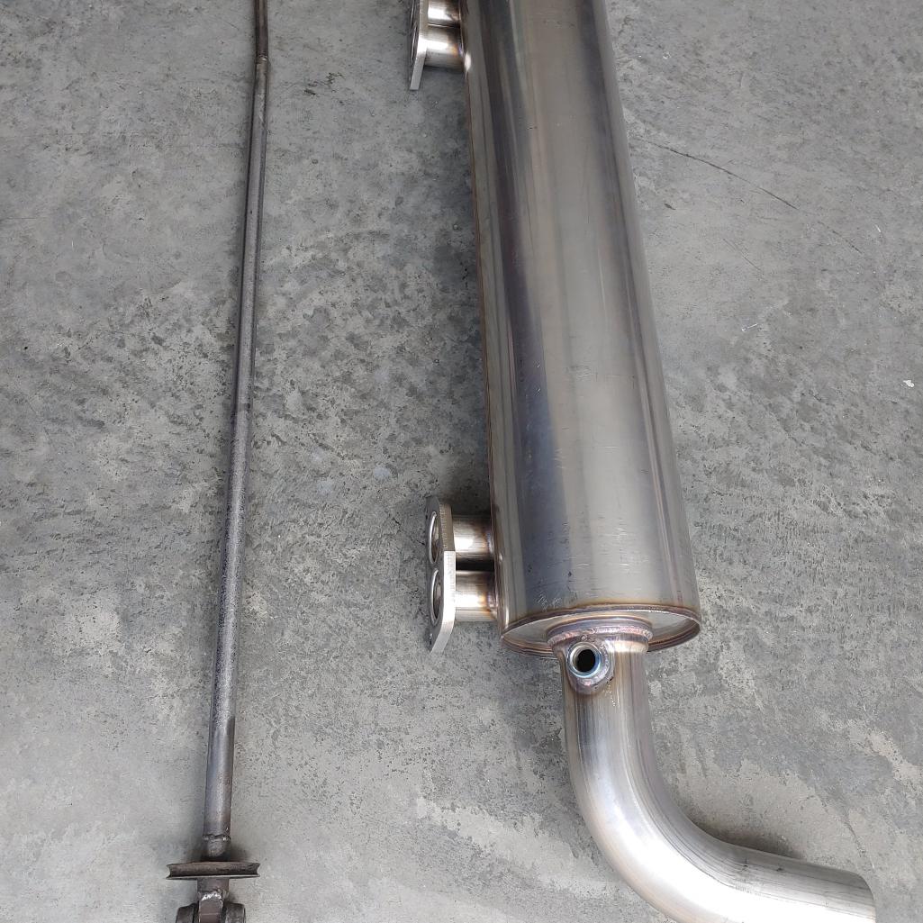

I just converted my 914-6 gearbox (901 dogleg) from tail to side shift.
I have now to find a solution for the shift rods. What would you recommend? Will it work if I am using the complete line (gearshift, front and rear shift rods) coming from a '73 model? What are the points of attention? Any hands-on experience? Many thanks. Philippe |

I made a fixture to do them.. Did one for @jwinner and one for another member along with my car. They work really well and not a very convoluted setup

dr914@autoatlanta.com use all of the late model stuff 73-76 straighten t... Aug 8 2020, 11:02 AM
Philippe Excellent. Thank you George. What do you mean by s... Aug 8 2020, 11:25 AM
Mark Henry
Excellent. Thank you George. What do you mean by ... Aug 8 2020, 12:13 PM
rgalla9146 as suggested above
This was assembled from a ... Aug 8 2020, 02:03 PM
Philippe I still do not understand why the rear shift rod n... Aug 8 2020, 03:19 PM
Philippe I guess that the answer is because of the headers ... Aug 8 2020, 03:25 PM
sixnotfour stock one cut and straight piece added
stock one c... Aug 8 2020, 05:43 PM
roblav1 I did what 6not4 illustrates in the 1st pic. Stra... Aug 8 2020, 10:02 PM
Philippe Thanks Folks. Very useful. I know what to do. Will... Aug 9 2020, 04:22 AM
Philippe I have bought a lot of second hand gear shift rods... Aug 29 2020, 03:00 AM
mlindner Have Ben make you one (mb911 or Tangerine Racing. Aug 29 2020, 02:51 PM
