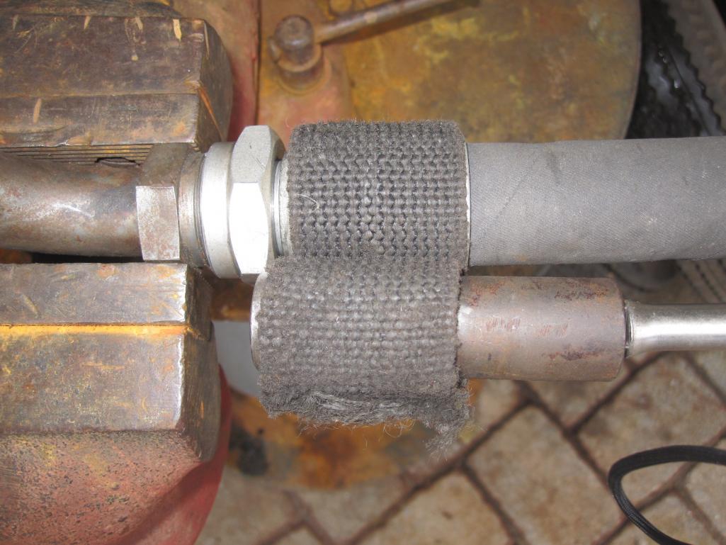

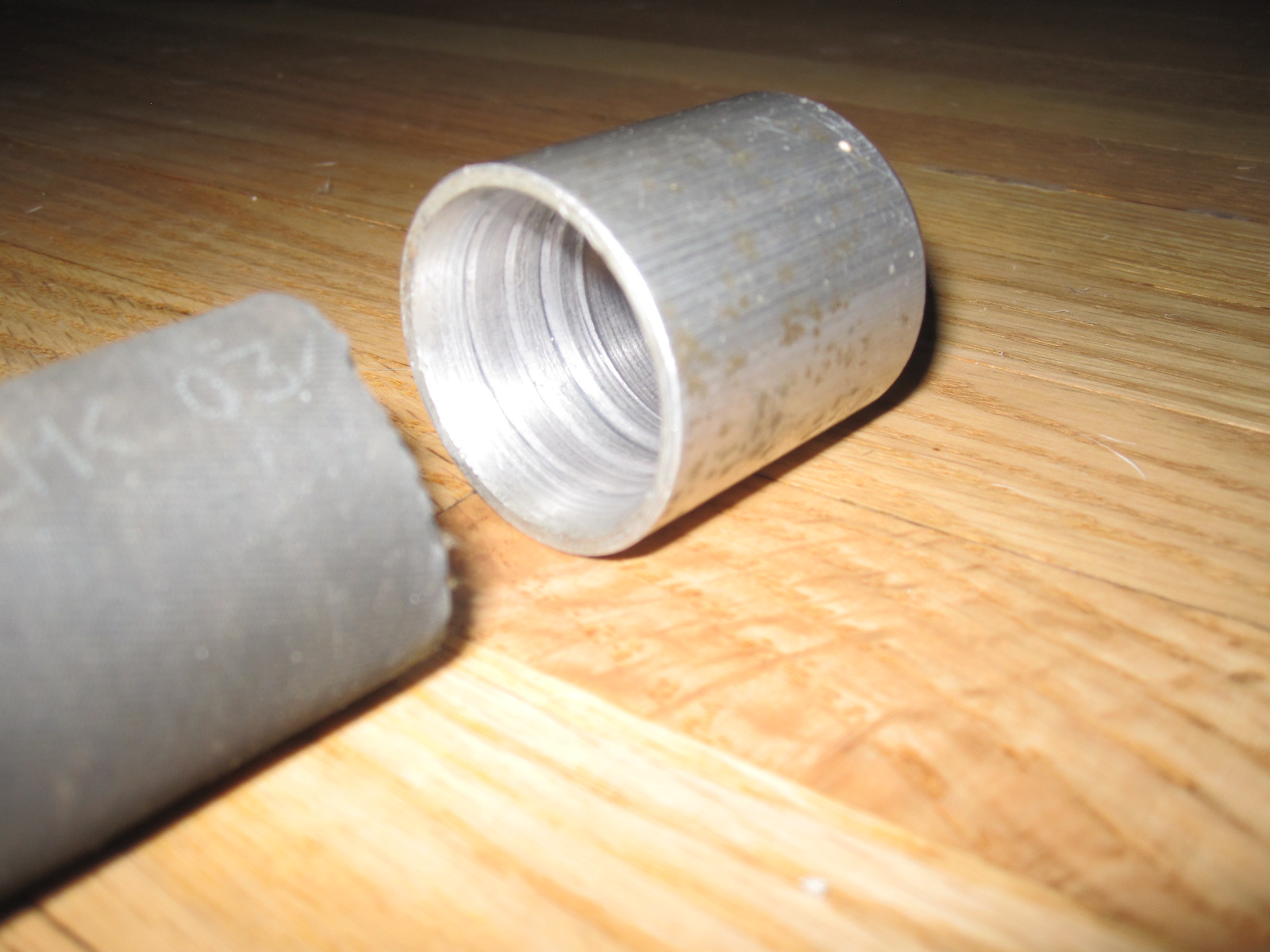

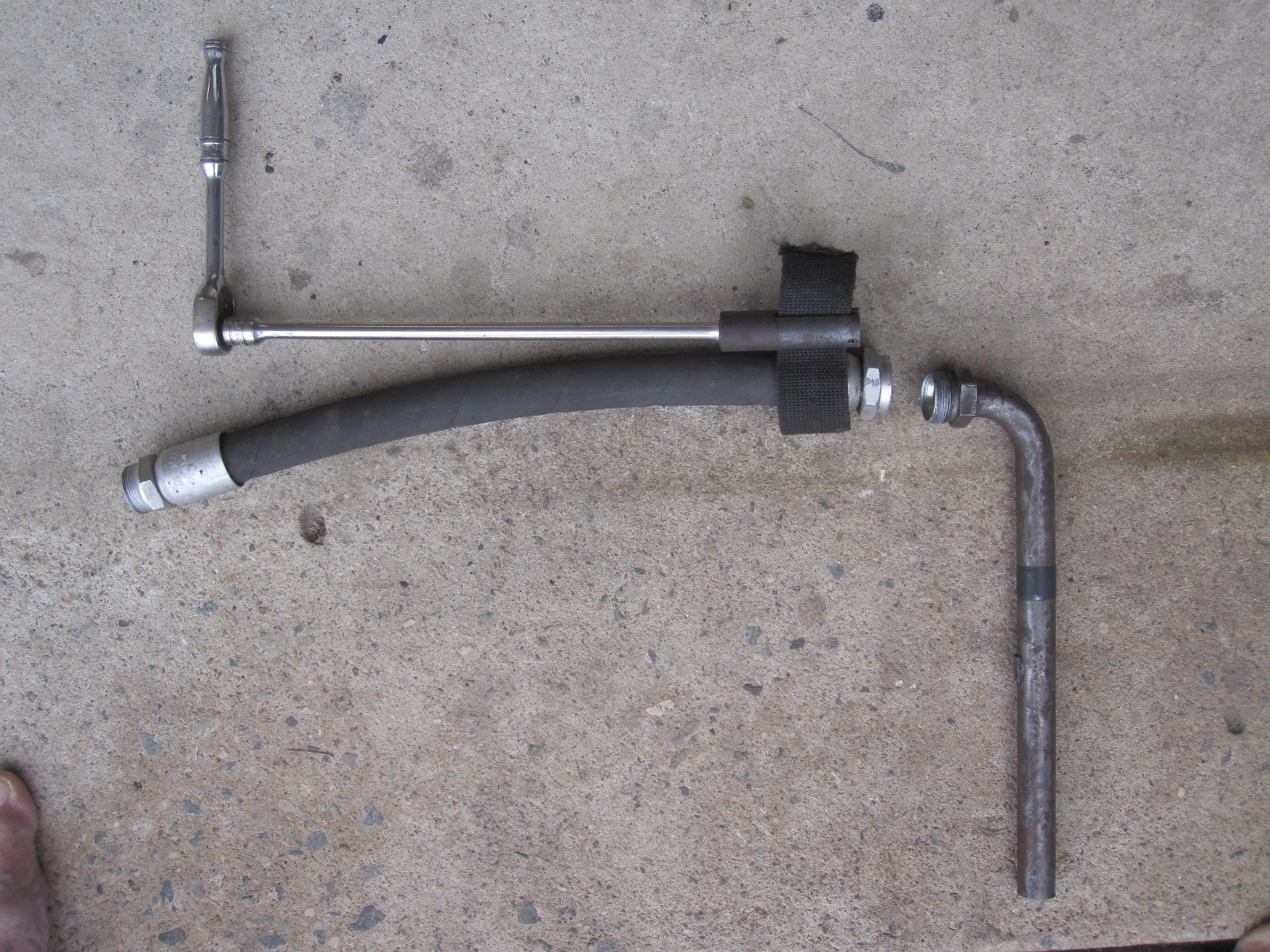

All threads are conventional, no reverse except the collar which is rotated
onto the hose as the first step. It is easily installed by hand to full depth.
You'll need a piece of plumbing to tighten the nipples against to assemble.
See pics.
The long extension is to stabilize the strap tool.
You may have to use rubber gasket maker to increase grip between the strap tool and
the alloy collar.
