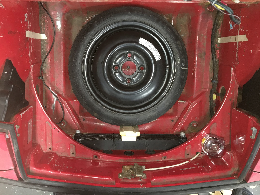

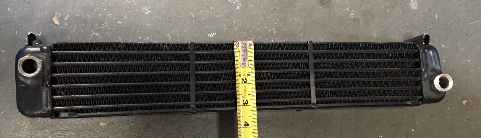

I got a couple of MBZ ones from Bruce Stone. I chose the smaller one (6 pass) of the two so it fits under the shelf, as you can see in the mock up below. Not sure yet if I will be using the fittings it came with, or AN that would be welded on the end tanks.
This one will be use on a 4 cylinder car.
