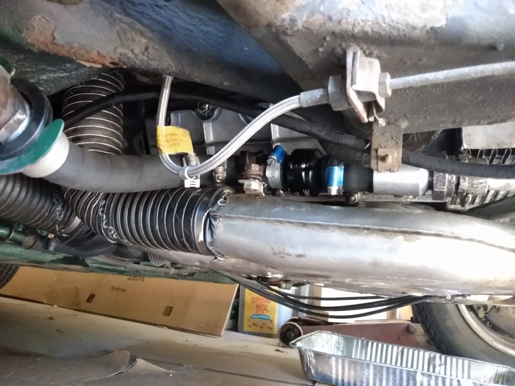

Bought one of the Rothsport oil valves because I was tired of cleaning up oil after taking the car out. Installing it was my weekend project (what did you do to your 914...?) Had the pull the heat exchanger, and the hose connection at the oil cooler came off surprisingly easy. The connection at the U bracket is another story. It hasn't been loosened in at least 30 years and having no luck breaking it loose. Any suggestions?
And before you ask 'how did I change the oil?'; the car has been driven less than 10k miles in the last 30 years, and 'oil changes' were done almost on a continuous basis by refilling since the leakback was so bad anytime I drove it. New lower valve covers & gaskets helped, but it still drained about half the tank when it sat for several months. Attached Image Attached Image

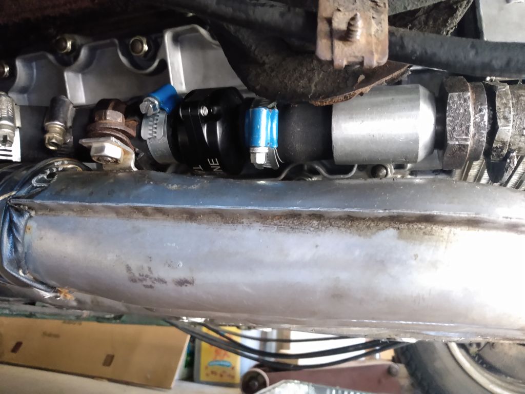

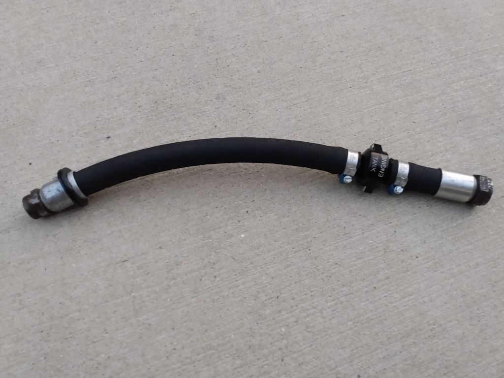

So, "with a little (LOT) help from my friends...", Success! I'll celebrate in about a week once I make sure I'm not getting leaks from the hose replacement. As you can see from the pictures, it's a tight fit with the stock heat exchangers. The valve needs to be very close to the oil cooler connection to allow the HE clamp to be used and avoid too sharp a hose bend. Had to trim the hose down a bit from the original picture to get it to fit properly. (The 2 extra clamps are to prevent the hose from crimping at the bend until use/heat form it better.
All in all, a bit of an adventure. Once you know how it all comes apart and can beg/borrow/buy the proper tools, it isn't too bad.
