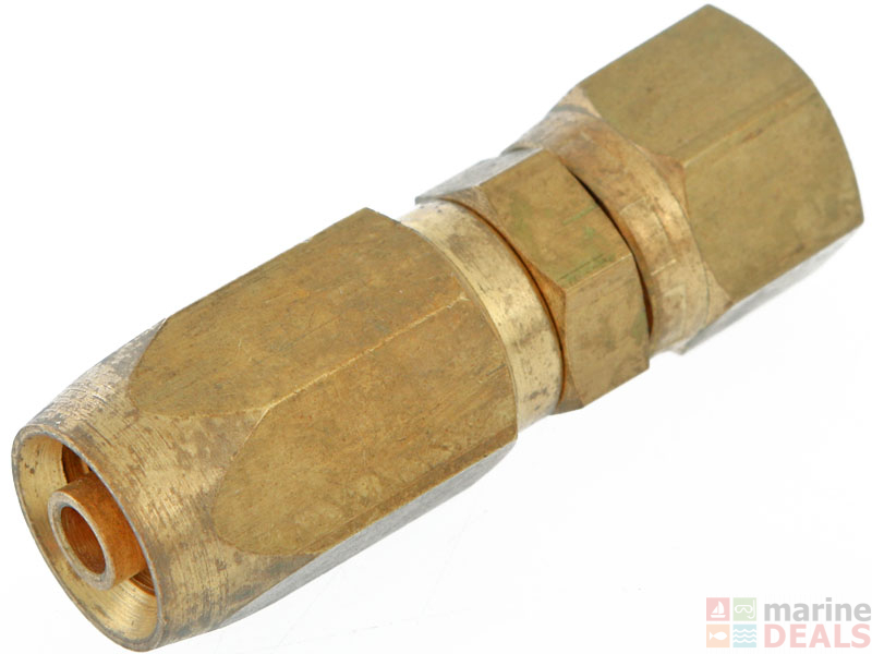

John I only mentioned the outer alloy piece was LH thread,these reusable fitting are different to the ones we used on the ships as our outer collars were steel and had a hex on them.....much easier to take apart and assemble.

Yeah, this would have made things much easier. That aluminum collar is slippery, even with a strap wrench. I did understand the LH reference though; the outer collar 'screws' onto the hose and it is opposite/LH.
