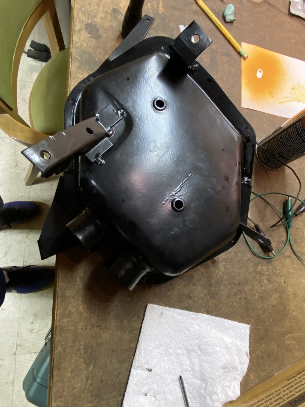

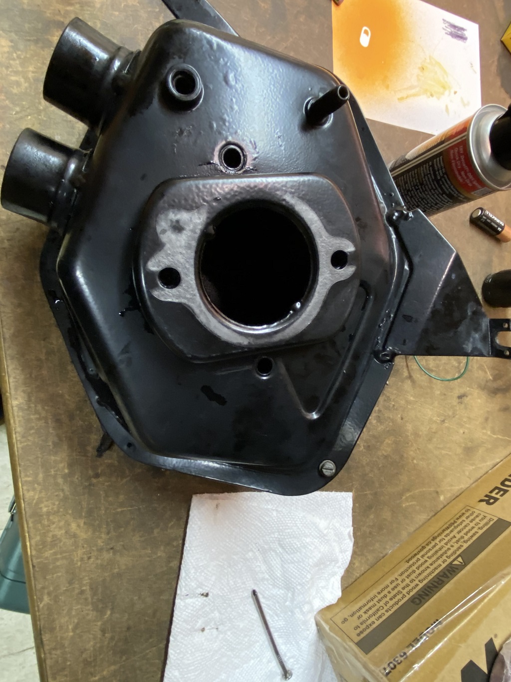

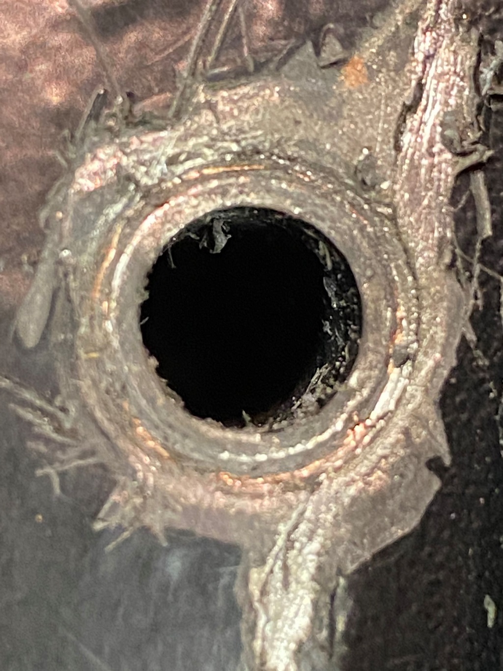

I removed the plenum and located a crack on the top side and possibly the beginning of r one the other side. I cannot see any light through these cracks but suspect when the engine gets hot they open up.
Also the TB mount does not look even, I will also remove the power coat and sand the surface flat.
I started to clean them up and will weld them tomorrow and put it back together
