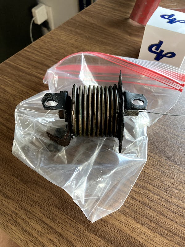

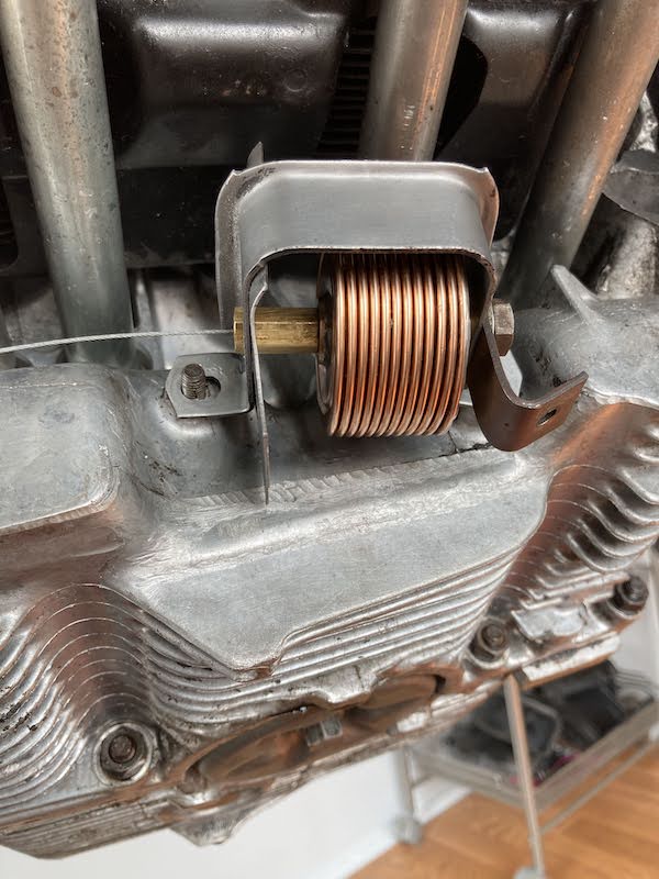

Thermostat bellows were blown, so a quick search pointed me (and my wallet) in the way of Awesome Powdercoat.
The new brass hex screw that came with the kit was slightly larger diameter than the old one, so 5 minutes with the Dremmel opened up the hold in the side of the bracket enough to ensure the thermostat can expand without binding.
