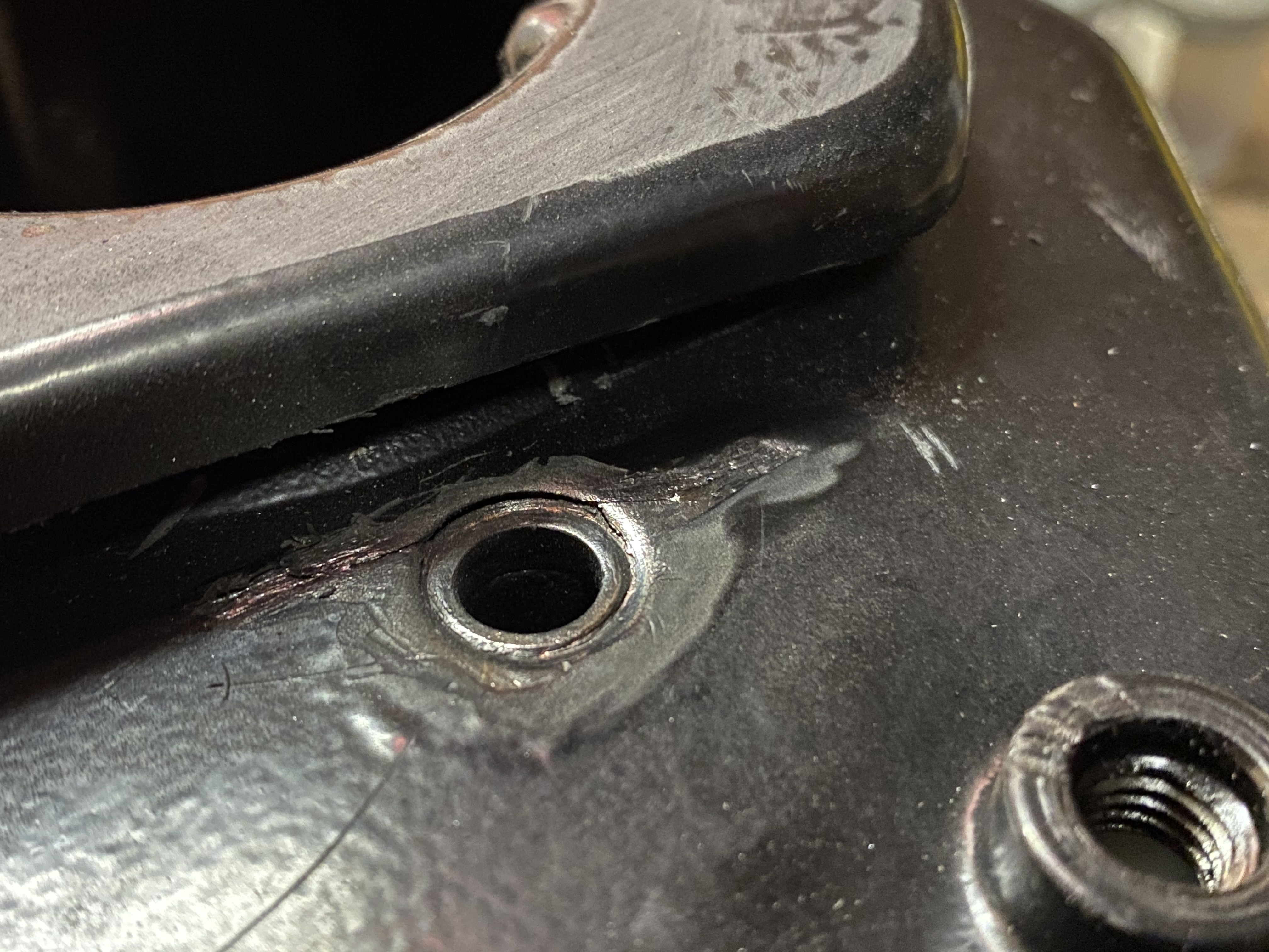

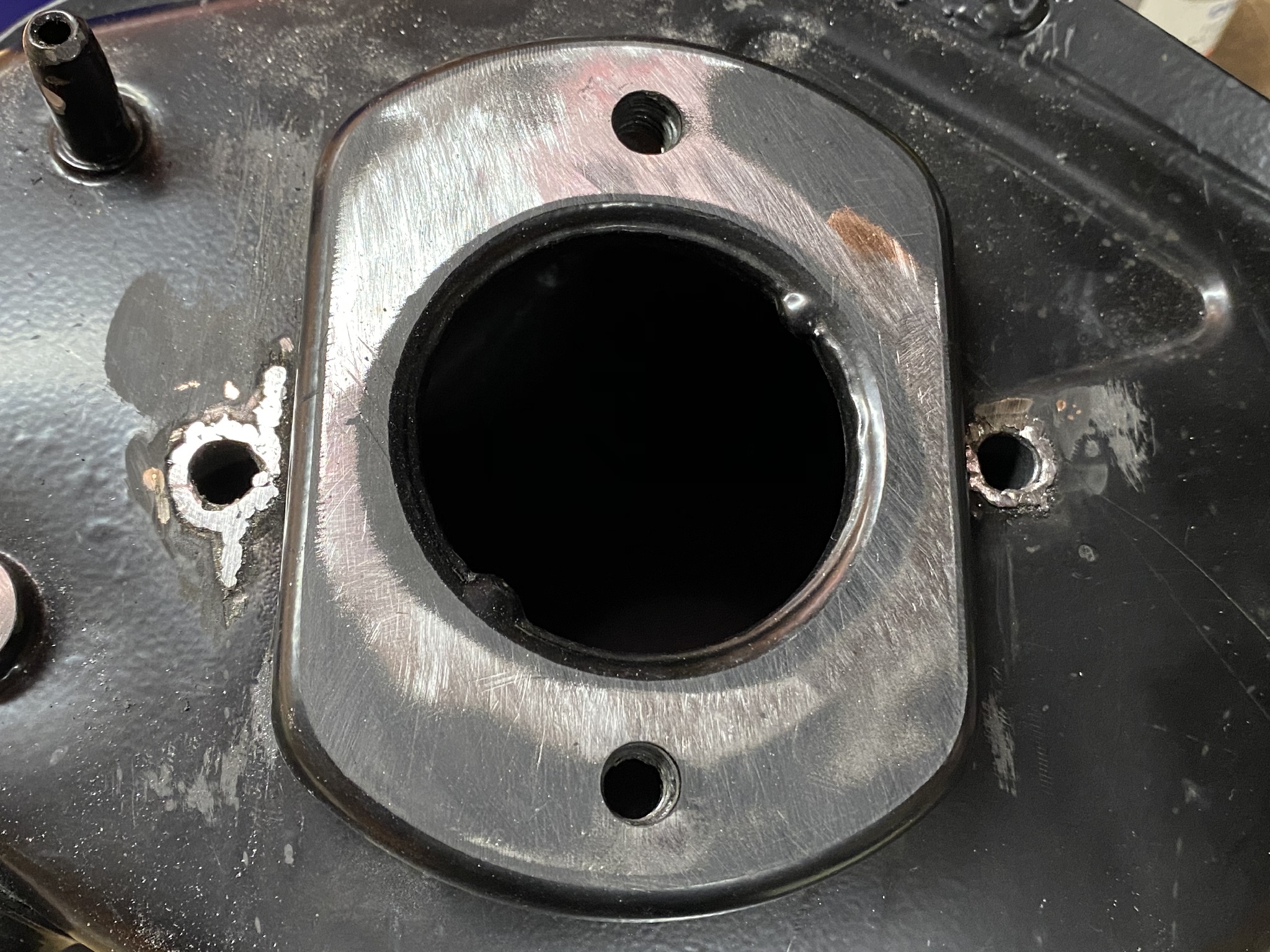

The crack exposed... (IMG:style_emoticons/default/biggrin.gif)
and hopefully repaired. In the process of waiting for the paint to dry and then will reinstall.
I would like to learn to TIG weld... but will keep practicing to MIG weld

QUOTE(solex @ Sep 7 2020, 04:18 AM) *
Well done on the welding...metal isn't very thick in that area,Tig may have been too hot anyway.
Make sure the TB and gasket are well sealed on the plenum,please report back after test run.
