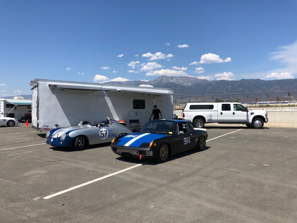

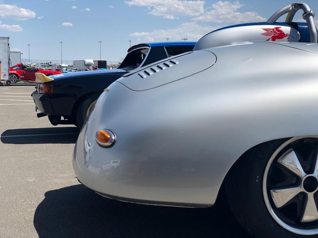

Had 1/2 of a great weekend despite the heat. Was 115 Saturday, car ran warm but well. By Sunday, she only made it out one session before electronics succumbed to the heat. New lightweight battery, here we come! I was able to drag a friend out, he showed most of us up on his potent ‘57 speedster.
