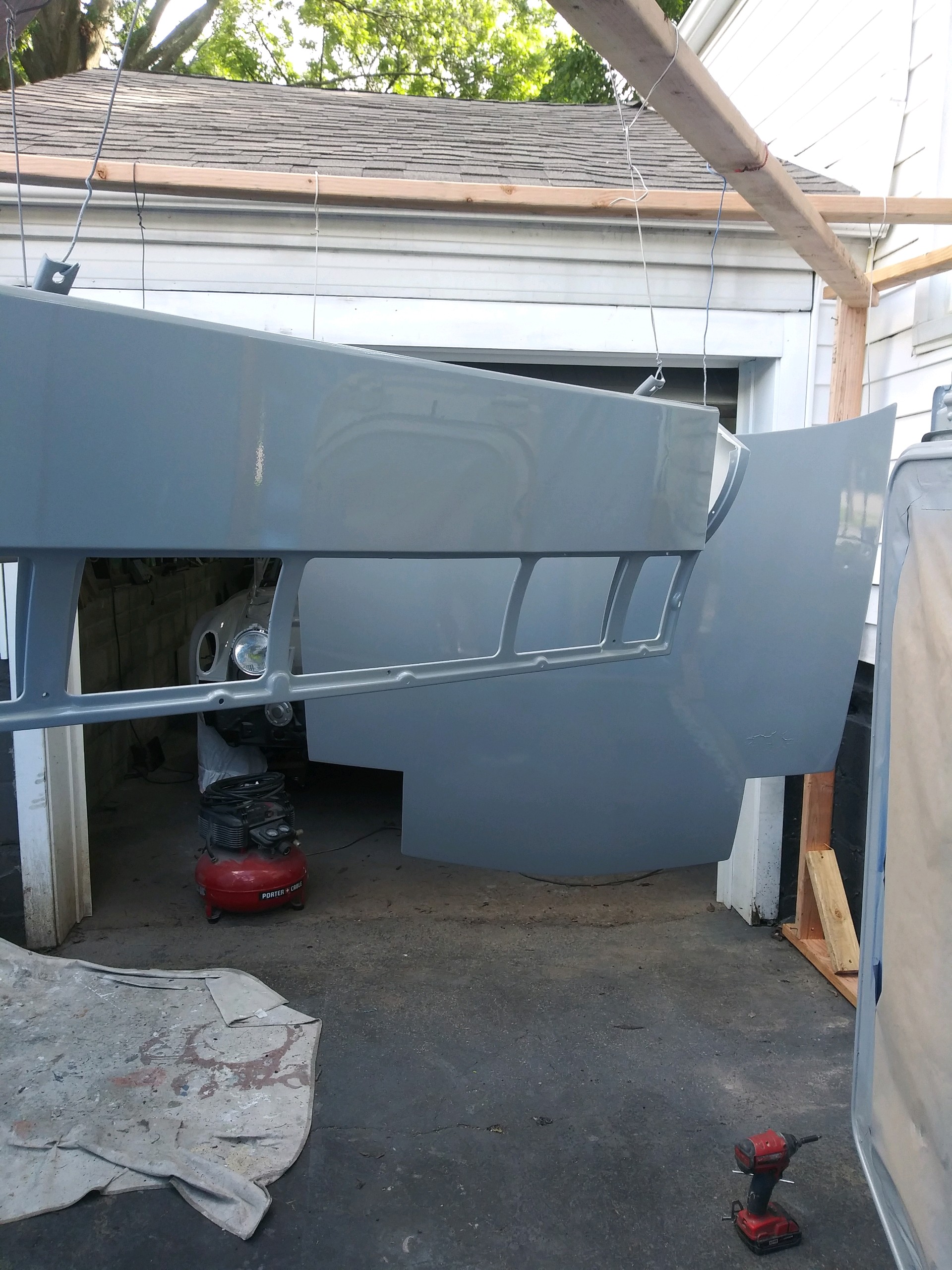

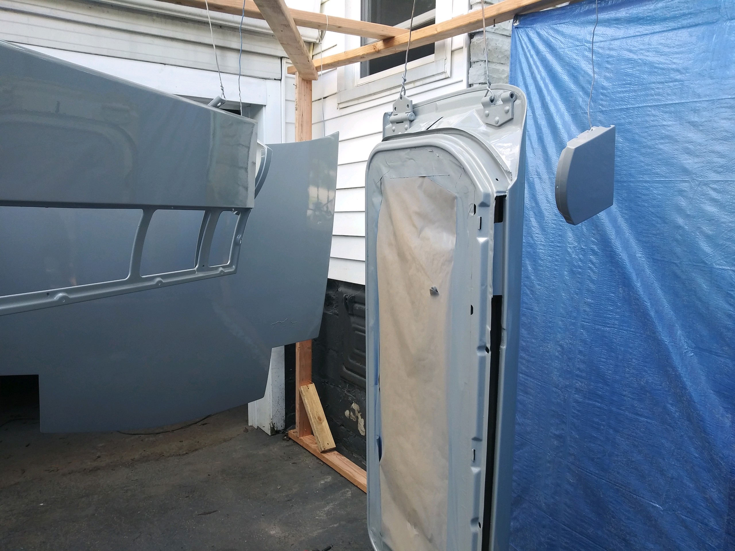

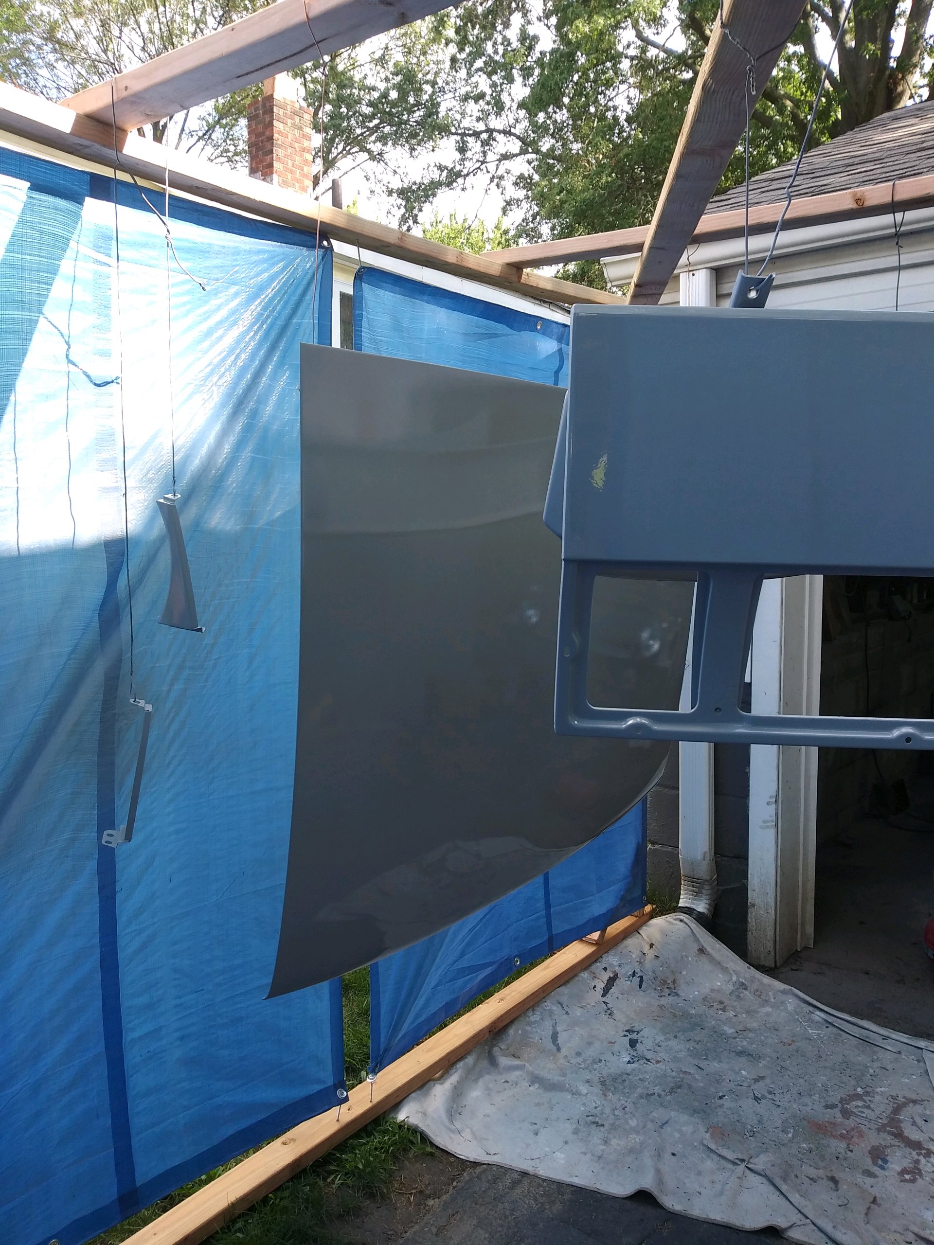

Thank you! Yes, I have done 100% of the work myself (sans the machine work on the axle shaft for the 944 CV) in the little one car garage you see it sitting in. Believe me, there was a lot of griping about space and a few choice words at times. I have an oversized 2 car garage and 4 tool boxes of tools at another house as well as my large air compressor, but its 45 mins from here and I have a tenant in that house now. I actually used a cheap LVLP sprayer and the little pancake compressor you see in the background of one of the pics to do the priming, painting and shooting the bed liner. Yes, it taxed the compressor, but I made it work. I had a makeshift "spray booth" set up in my driveway for a couple of days while I painted the hood, trunk, light covers, doors, etc.
Attached ImageAttached ImageAttached Image
Tarps were set up on all 4 sides. To protect the house and garage door. I had 24" box fans set up on one side with 24" furnace filters attached front and back to collect and move air out of my "booth"
