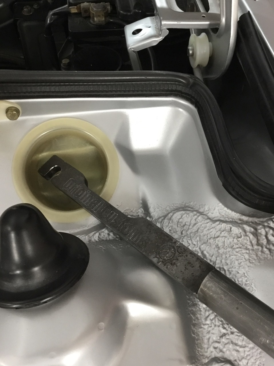

The teener kicked my ass tonight! I simply wore myself out trying to get the rear trunk torsion bar behind the trunk roller.
I searched for as much info as I cold find before beginning this task. I modified my 12" adjustable wrench as mentioned on other threads on this topic. This tool proved to be a very good lever for pushing the torsion bar back. I could get the torsion bar pushed/twisted back well enough but I could not get it around the hinge roller/pin. I tried several times but could not find a way to get the roller behind the pin on the hinge.
I tried to remove the hinge then hold the torsion bar back as far as I could and then reinstall the hinge -This is the task the wore me out! No matter how or what I tried I could not find a way to get the bar behind the roller.
Anyone know the secret/technique to get the torsion bar in place?
Here is a pic of the wrench with a notch cut out on the end.

Great tool, glad these are still available, got mine last week, it was finally time. Clean install, still have 10 fingers.

olav   To get that puppy on you need to: Preload torsion...   Oct 4 2005, 10:51 PM
Doug Leggins   I thought about the shock kits, even had it on the...   Oct 4 2005, 10:53 PM
olav   There's a "special" tool to do this with and t...   Oct 4 2005, 10:59 PM

Doug Leggins   SUCCESS!!!! http:/...   Oct 5 2005, 08:30 PM
Doug Leggins   transitioning from the 1/4" extension to the notch...   Oct 5 2005, 08:32 PM
Doug Leggins   Using the notched wrench to push the torsion bar f...   Oct 5 2005, 08:36 PM
Doug Leggins   Reaching in from the engine bay with a large screw...   Oct 5 2005, 08:37 PM
Doug Leggins   Screwdriver used to pry the bar around the end of ...   Oct 5 2005, 08:40 PM
Doug Leggins   Torsion bar on the back side of the roller pin...   Oct 5 2005, 08:41 PM
Doug Leggins   Slipped the roller on the pin, cautiously eased up...   Oct 5 2005, 08:45 PM

ClayPerrine   This is a nice picture representation of the proce...   Oct 6 2005, 10:10 AM
Mikey914   No need to make the tool, this looks like the tech...   Nov 28 2017, 12:05 PM
JOEPROPER   :bump: Just bumping this thread because it's r...   Apr 14 2020, 07:46 AM
JOEPROPER   This helped. ALOT. 5 minutes or less with no hel...   Apr 14 2020, 08:05 AM

Mikey914   We just brought on McMark's tool for doing the...   Jun 1 2020, 11:55 AM
Arno914   Place some thick cushioning on the area where the ...   Aug 27 2020, 06:25 AM
Mikey914   Link https://914rubber.com/rear-trunk-spring-pre....   Sep 13 2020, 06:02 PM
