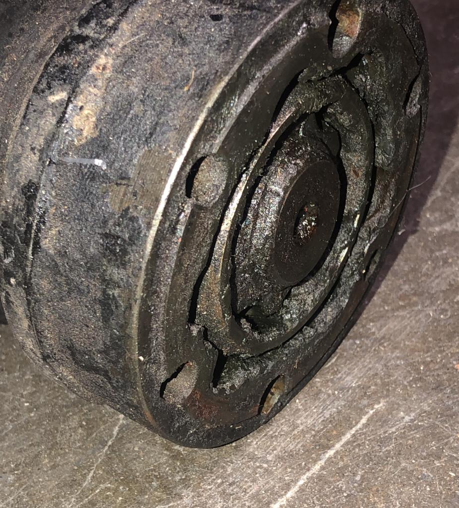

Working on that white Fresno car and I have two rebuilt CV/axles but one has pins, two per side, and the other does not.
I have two spare (needig servicng) that have dowels - can I just lmoves the dowels over to the ready to use ones? Thanks, cranking to try to get this done and I really appreciate everybody’s help! (I did try searching first) |

Tdskip Are all the CV/axles supposed to have alignment dowel pins? Sep 14 2020, 04:50 PM
914werke Perhaps.
The issue I alluded to in another thread... Sep 14 2020, 05:49 PM
Superhawk996 To further the response above.
Yes they are req... Sep 14 2020, 05:52 PM
914werke :chair: :agree: Sep 14 2020, 06:30 PM
Tdskip Thank you very much for the responses, I will do s... Sep 14 2020, 06:45 PM
Tdskip Just to follow on here and be more explicit, shoul... Sep 14 2020, 07:16 PM
Rob-O
Just to follow on here and be more explicit, shou... Sep 14 2020, 08:17 PM
Mark Henry
Just to follow on here and be more explicit, sho... Sep 15 2020, 04:29 AM
Tdskip Thanks for the information.
So with the VW ones â... Sep 15 2020, 06:47 AM
Tdskip Good morning. So I cleaned the various sets of the... Sep 16 2020, 07:23 AM
Mark Henry
Good morning. So I cleaned the various sets of th... Sep 16 2020, 08:02 AM
Rob-O A more definitive way to confirm would be to count... Sep 16 2020, 07:33 AM
