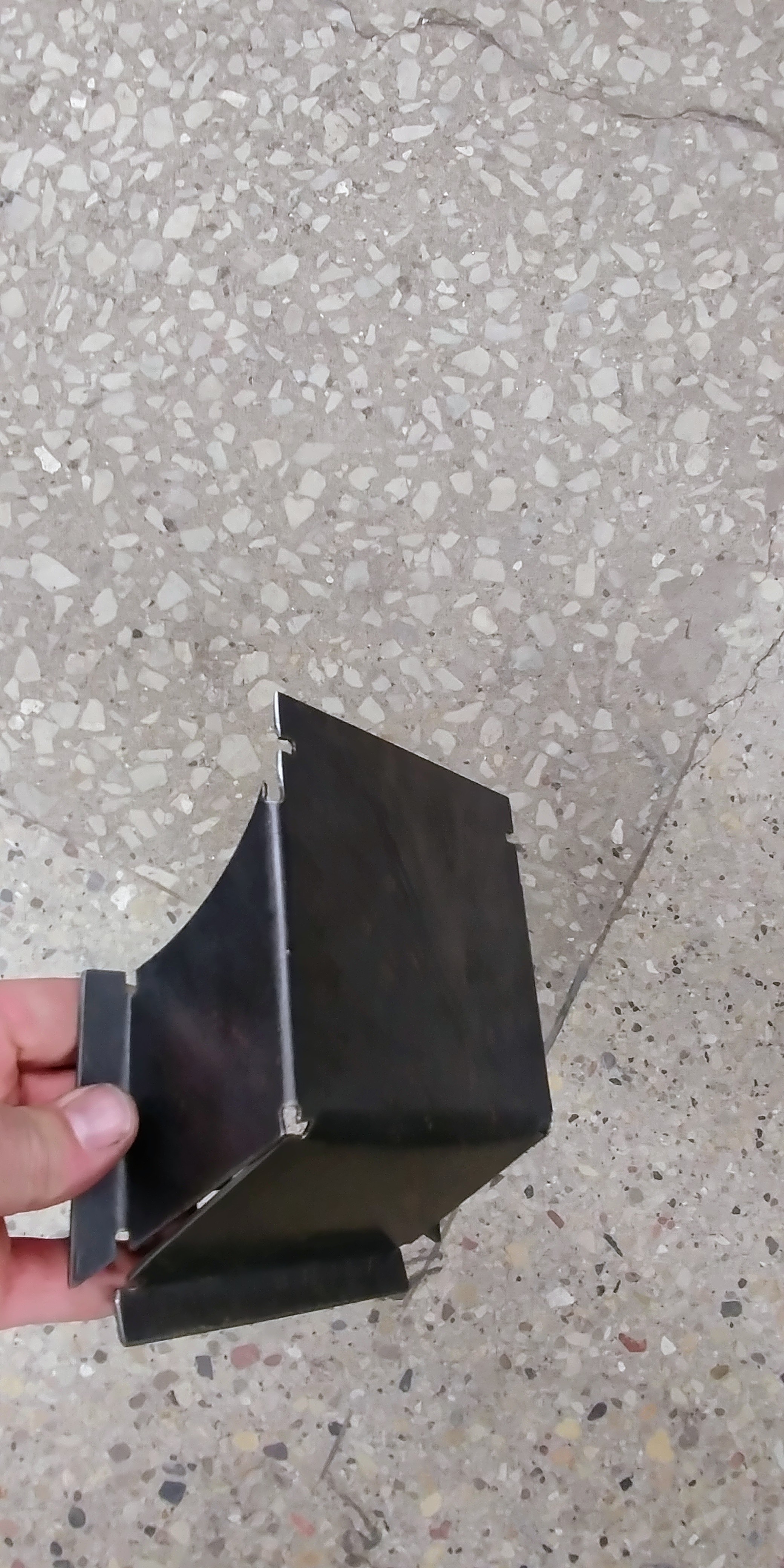

I am looking at having another batch of each laser cut. Any interest from the community for a group buy? Attached Image

I tested your GT muffler bracket and it does not work with a stock 2.0 banana muffler.
Dimension are a little off. Your C-C distance on the holes is 2mm too narrow. Part of the problem is that the stock mufflers have a seam that hits your bracket while your muffler are round and seamless.
The curved parts need to be wider to be able to use stock 911 muffler clamps. I think a two or three piece design would be better. I have found variation on the distance from the trans to the muffler. One U shaped part bolts to the trans and two separate parts bolt to the muffler. slotted holes would allow adjustment. I also tried it with a Scart muffler and it did not quite work there fr the same reasons. It had new SSI's which have thicker flanges than old SSi's or stock HE's. We even had trouble installing e stock 2.0 muffler hanger.
If my explanation is not clear I can draw up my ideas. But the GT type bracket is much better to directly support the muffler to the tail cone.
If you do not have access to a 2.0 trans engine setup I can test fit it and provide feedback.

Bruce - when I sold the bracket to you I told you it was designed to support Ben’s stainless steel mufflers. You told me you wanted to try it on the scart muffler but we agreed it might not fit correctly and the seam on a stock muffler would definitely not fit on the bracket without modification.
Our hardware kit comes with the correct size stainless bands to support the muffler. While it’s true that a different bracket could be made to fit other mufflers, this one was designed as an affordable recreation of the GT bracket and fits all the 914-6werkshop mufflers perfectly.
