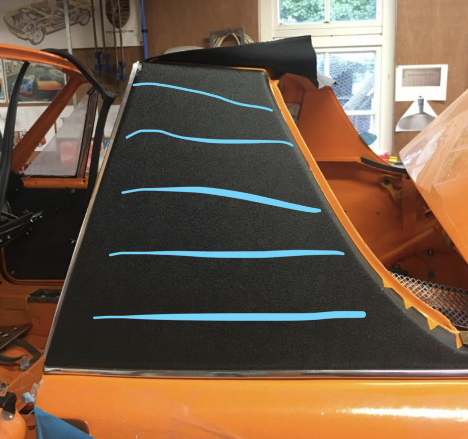

Interesting approach about the double sided tape!
Do you have a p/n or description of it? I don’t know if it’s my phone, but your picture looks like that there are “lines” showing. In what pattern did you apply the tape for in between the edges? Cheers! ![]() |

jmitro post 43 he used 3M super 90.
that's what I use... Sep 15 2020, 08:55 PM
raynekat
I agree, the best spray adhesive for this kind ... Sep 15 2020, 10:31 PM
wysri9 I am at the same stage and was all set up (having ... Sep 15 2020, 11:43 PM
wysri9
Interesting approach about the double sided tape... Sep 17 2020, 12:26 AM
Interesting approach about the double sided tape... Sep 17 2020, 06:07 AM
draganc PS: Great color, orange was my first choice but ha... Sep 16 2020, 08:58 AM
TheCabinetmaker I've removed a lot of sail vinyl. They used ol... Sep 16 2020, 03:11 PM
moldygreg I struggled with 3M spray adhesive for the sail pa... Sep 16 2020, 03:20 PM
iankarr DAP Weldwood Landau top and Trim adhesive. It... Sep 16 2020, 09:34 PM
draganc Excellent feedback guys - very much appreciated... Sep 17 2020, 07:30 AM
dt4
Excellent feedback guys - very much appreciated... Sep 17 2020, 08:17 AM
bdstone914 I am about to install the floor vinyl and the doub... Sep 17 2020, 08:59 AM
gms I use 3M 90
