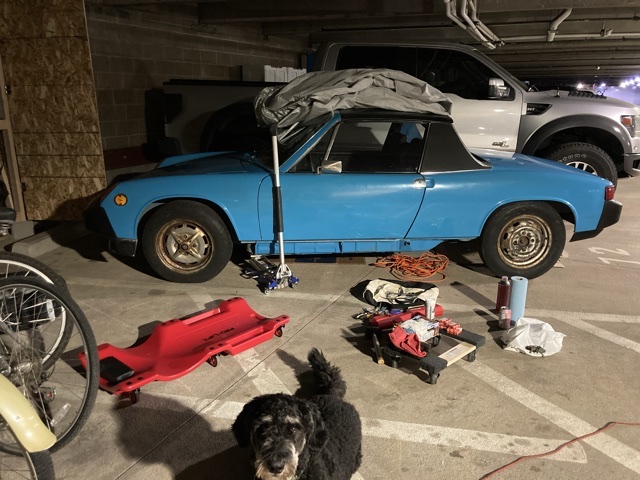

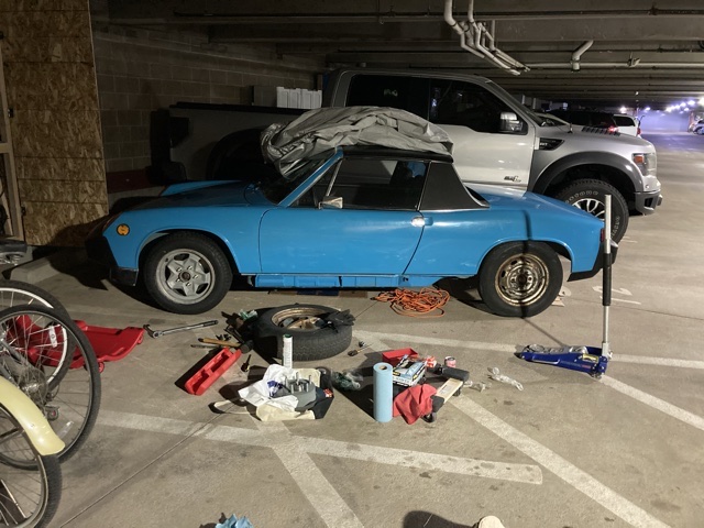

I am tackling the 5 lug hub conversion this weekend. 2 concerns right now:
  1. I have brand new front hubs in a box. It would appear that the PO fully installed and seated the inner and outer races into the front hub assembly, but I do not see any signs of grease. Do I need to remove the races to ensure they are greased, or would these be ready to install?
  2. It appears that Swepco 101 is the hub/bearing grease of choice. Can't find it anywhere in Denver on short order. Have others had success with Lucas X-TRA heavy duty grease? It looks like what @iankarr uses in his install video, but always nice to get group feedback.

Fronts done. Rims look rough, but really happy with how the 5 lug conversion bolted up. Tried to remove the nut on the rears and broke my socket extension. Off to HD for an impact driver and to try the rear again tomorrow
