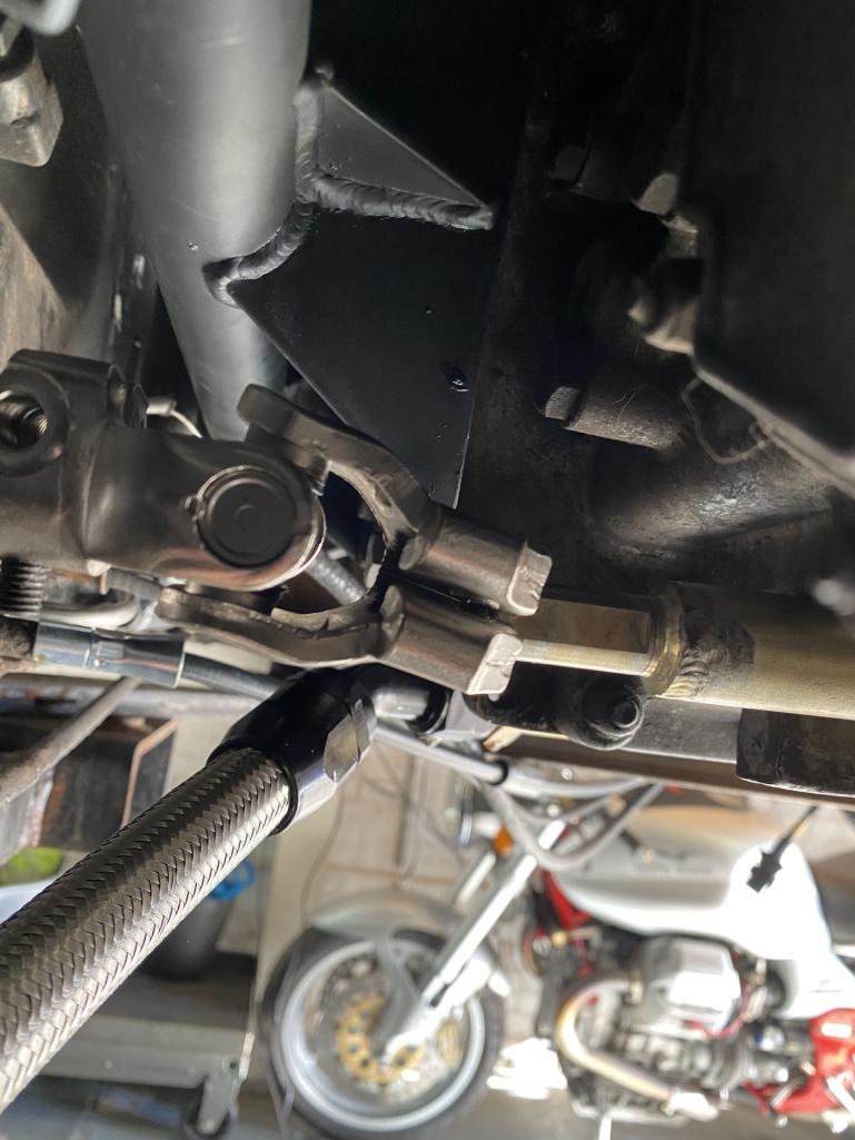

So... the engine is in (I’m using the NaroEscape -6 front mount) and, seeming because of the mount, it sits lower than stock. The Patrick Motorsport -6 shift linkage rod I intended on using, wont work. It interferes with the engine case and doesn’t seem to have a workaround. If the engine were 1/4” - 1/2” higher at the firewall, it looks like it would slip in, but alas, the engine is not going anywhere, lol.
I’m tempted to just bend the PMS bar end upward (maybe a couple inches from where it goes from the narrow shank to the bar rod) to give it the clearance but that would change the angle it goes into the rear bushing and connects to the shift lever... so I figured I’d ask if anyone else had an issue with the bar hitting the engine case and any options I might have. I’m OK with modding the old -4 rod too. Might be worth a shot but figured I’d ask here first.
The other threads I found look like the stock rod modded is the move.
Thanks

Thanks everyone. Just getting back around to this issue now. Had I known the engine was going to cause shift rod interference sitting as low as it does, I would have asked Translog to weld it in 3/4" higher. I welded it exactly where they say to weld it. It looks exactly like that blue pic above.
The rod only moved back/forth and rotates so I'm not dealing with any side clearance issues with the heat exchanger box... just the bottom of the engine case. I think I can "notch" it where it will go under the case, back up and straight into the side shifter guide without any funky geometry.
