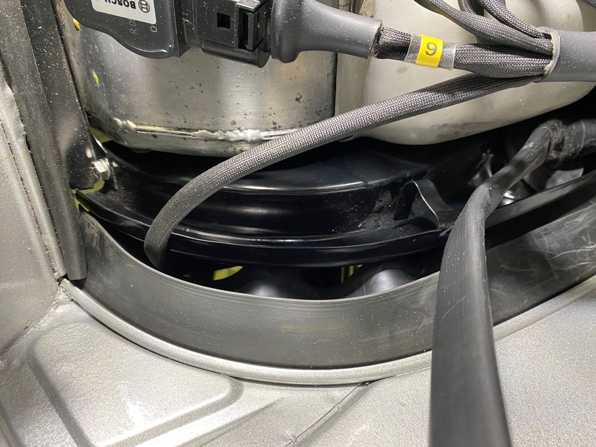

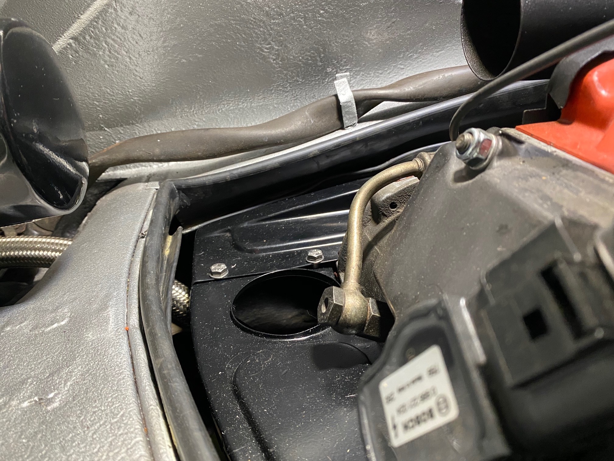

This >>> 100%. Maybe even higher up... the front rubber seal would slip under the -6 engine tins if it were up almost an inch. It absolutely pulls it forward too as my trans mounts are at the very limit of what I would consider safe, lol. It pulls the engine closer to the firewall which may translate into being off for the shifter too... (IMG:style_emoticons/default/confused24.gif)
Here's the gap I'm left with at the front and rear rubber seals using the Naro mount installed as instructed. Like I said and others have suggested, if youre going to use it and want the engine to fit closer to how the stock 6 would fit, welt the mounts UP 3/4"-1" on the firewall from off the bottom ridge.
